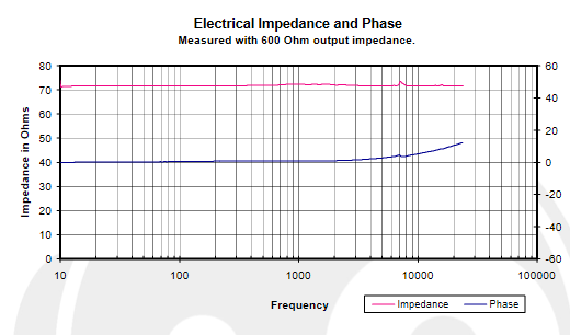

At least with the lcd r impedance is likely locked at 2 ohms, like most planars with a dead flat impedance curve
LCD 2 impedance curve for example
But it’s always good to assume there could be dips lower for safety. But I bet the impedance is pretty flat and linear
