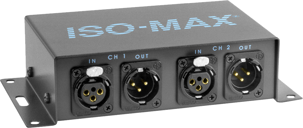

Balanced to SE will be my SFD-2/SFP-3/DAC replacement to my Chord stack → Stratus or Pass HPA-1/Black Widow.
Trying to avoid the cable method,
I have tried:
Jensen Iso-Max PI-2XR:
This was okay, nothing to write home about, the SFD-2 mkii has super low XLR/RCA output due to the HDCD chip.
