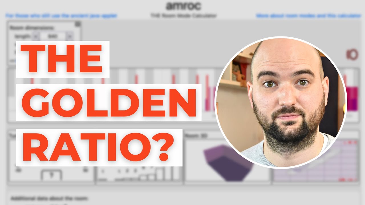

Due to existing lines in the house, it will work much better if the room is 17’ long. That put me on a bit of a hunt and I found this video:
Based on that, I calculated that going 8’ x 17’ x 13’ would actually yield a room with better acoustic properties than the Golden Ratio:

There is a lot of debate, all you really want to avoid is exact multiples of the same length, because it causes room modes to stack up, any set of lengths with a small number of common divisors is probably going to be 90+% as good as the best possible (By whatever criteria you decide best is based on).

Yeah. As you said, as long as you’ve avoided exact multiples, you’ve avoided the worst problems. Right now it doesn’t cost me anything to move one of the walls a few feet one way or the other so I might as well pick a distance that is good by some criteria.
