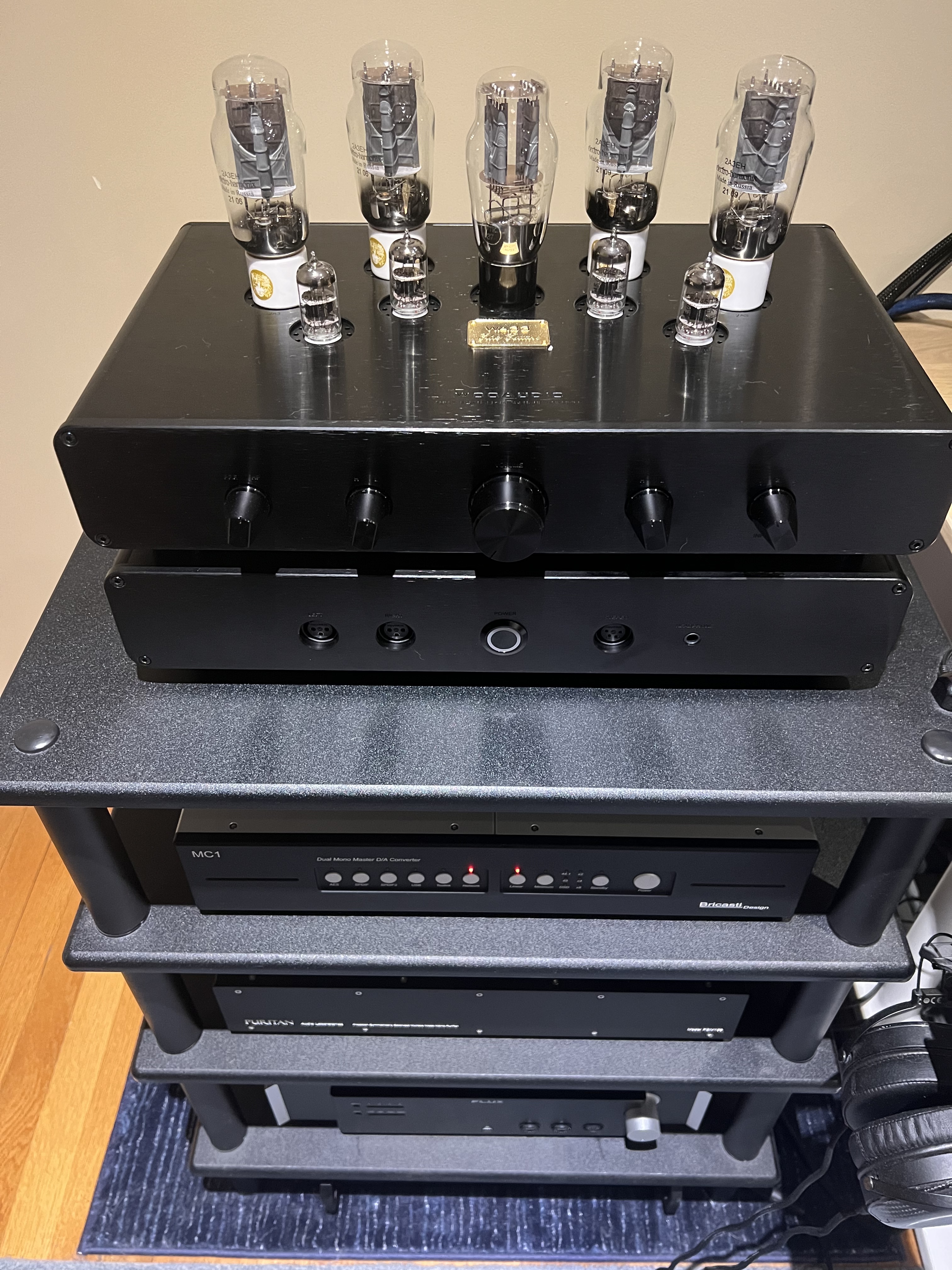

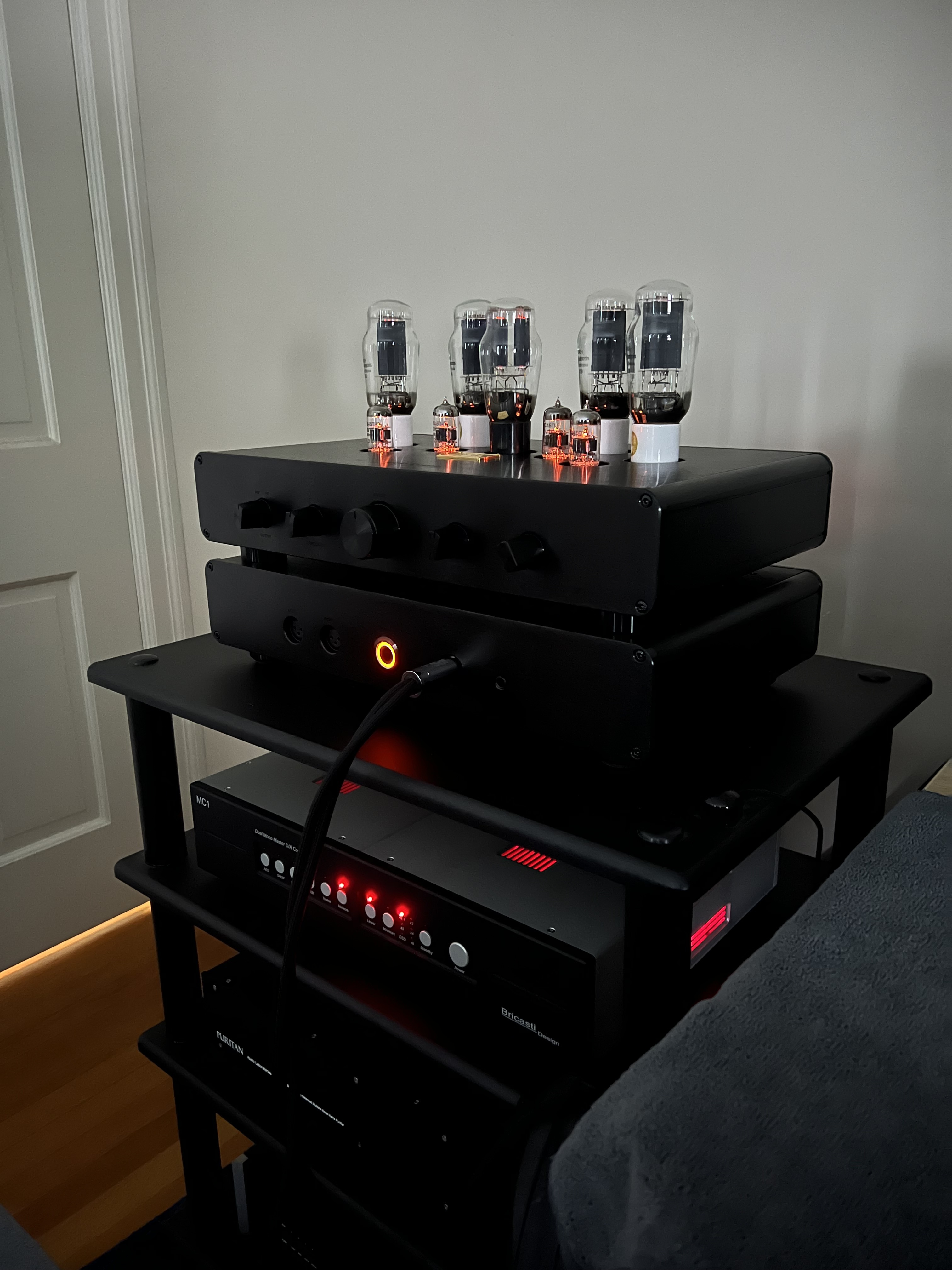

Didn’t think I’d be taking delivery of an amp for my 1266 so soon but here we are. WA33 Elite arrived today, stock tubes and no jps wiring. Listened for about an hour and letting it warm up again for some listening tonight. Here are some pictures and will update with impressions soon.
Thanks to @sa11297 and @Draaly for connecting me to the dealer I ordered from!
