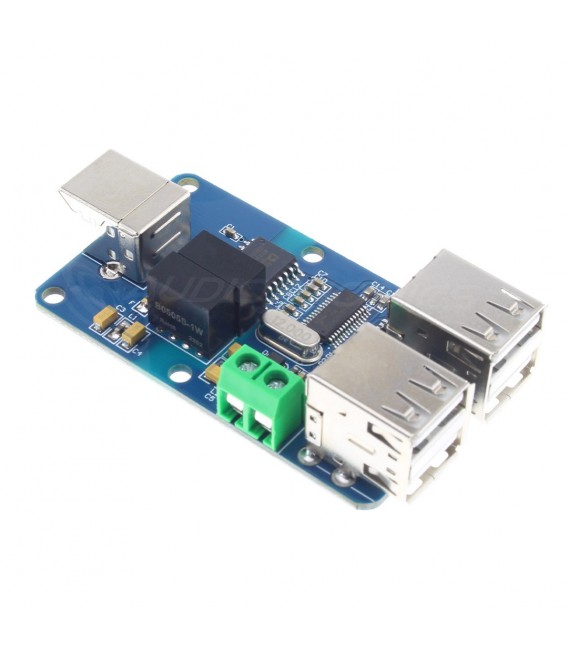

Don’t know if it would help to better isolate the usb port from the Pi.
