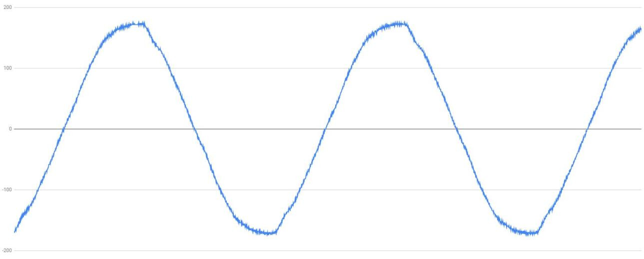

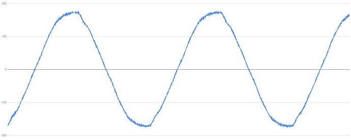

For point of reference this is what my incoming AC looks like, and no ammount of filtering is going to make it look very much better

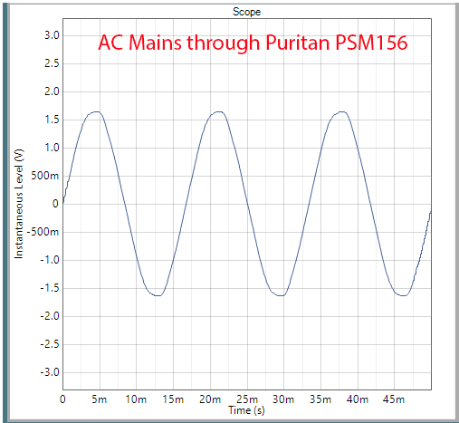

That being said, the lower cost of the Puritan is tempting plus the simpler aesthetic and more plug and play nature is a plus. My understanding is that it sums the positive and negative parts of the AC waveform to remove noise and any DC component that’s there. Based on that I was thinking that it could fix the peaks of the waveform that in your image are not symmetrical. But based on graphs from ASR (I hate this website lol but it’s the only place with measurements of the two) it looks like the Puritan doesn’t fix the waveform:

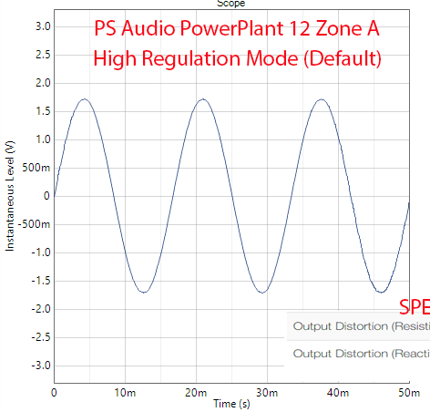

But regeneration does:

No I captured it with a scope straight out of the wall socket. You need to know what you are doing to do this safely, so don’t attempt at home unless you know what you’re doing.
There’s actually no (sub mV) DC offset, I was a bit surprised that neither the isolation transformer or the filter I had on hand made any observable difference, didn’t even remove the obvious high frequency noise. Puritan could very well be better at that, but it won’t fix the actual waveform.
