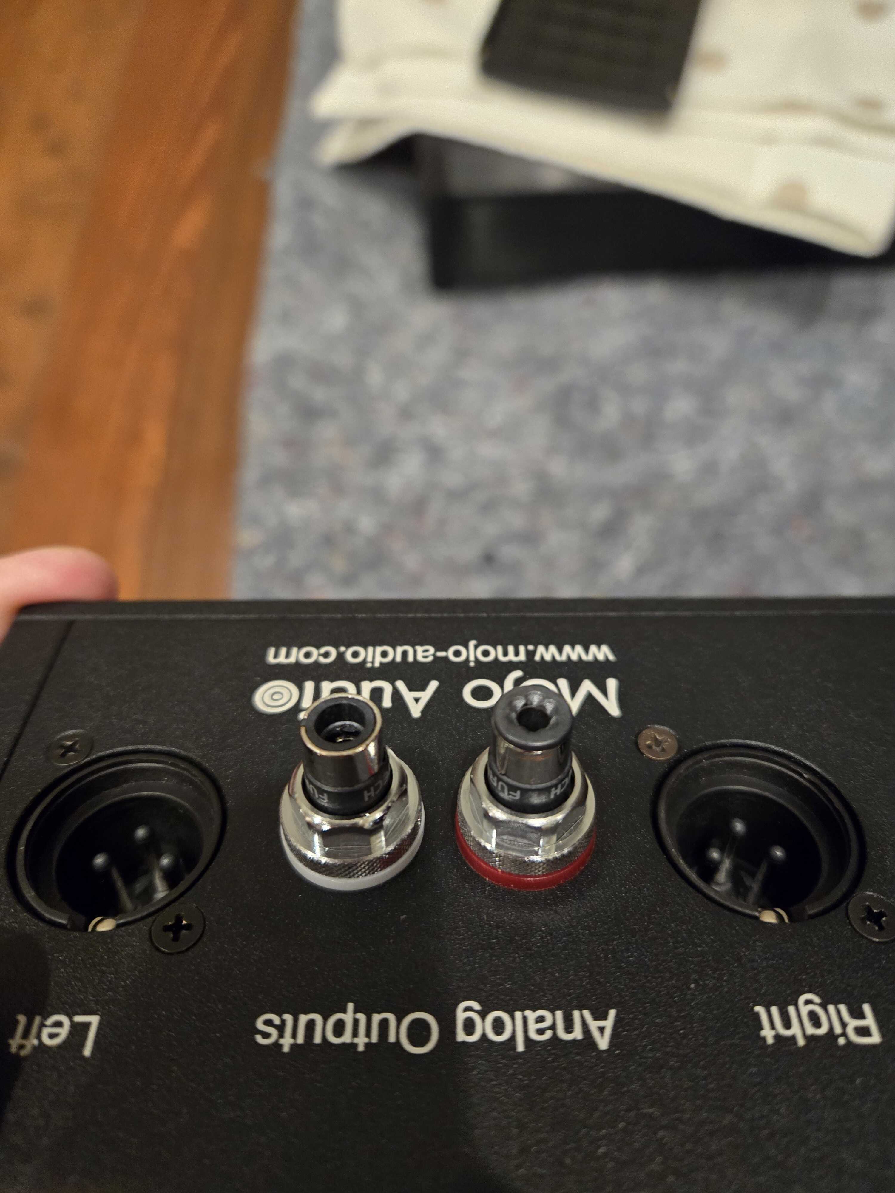

As far as the harware, the Furutech rca outputs seem small and my Audience cables arent getting a good grip. They are loose. One of the inputs is also missing a “cap” which the seller noticed he never had from his own pictures. The seller was one of the nicest dudes I’ve met in a while.

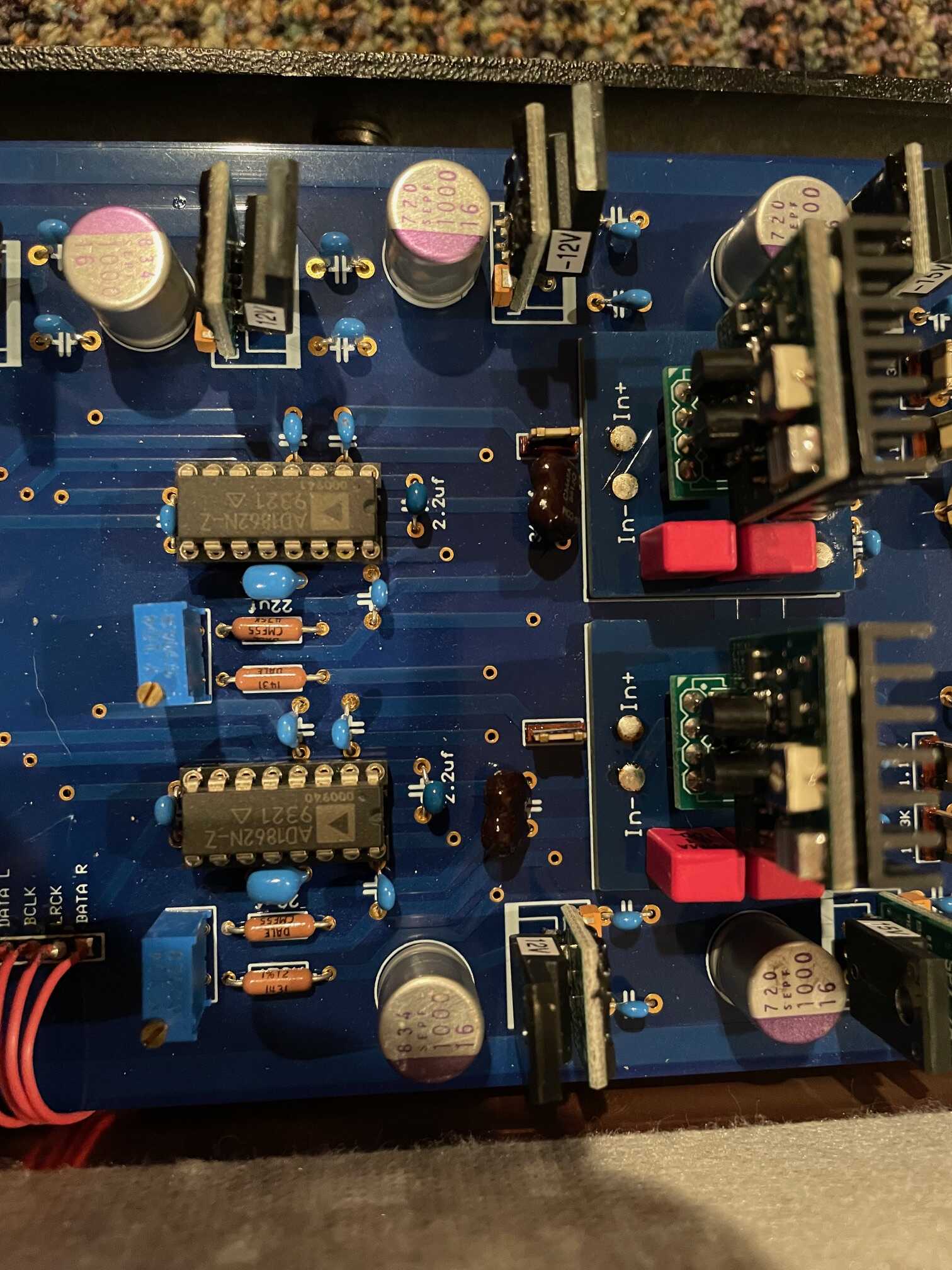

Nope, those are not the dac chips. The section next to it has the two. They have what looks like a youtube logo on them.

Those back RCA should look like this. Ive never seen one of those caps pop out and not sure if its a simple push in thing. But i would think it may not most give the most secure signal. Maybe the guy put in the wrong sized or a fat rva and it pulled it out?

Those look Z-ish to me.

Thanks. Yeah, the spdif rca has a cap. Do you think i should i reach out to ben or Furutech? As it is, both rcas generally are loose.
Is it loose in the socket, or is the whole socket wiggling? It may still have warranty. I sm also not sure if those caps do anything mechanically besides hold it tighter, but it should still be there.

For the rca i would guess the previous owner did a bunch of cable changes, or had a pair out of size spec that pulled the cap out and may have stretched the sockets a little, that is if the rca plug only wiggles and not the whole socket.
If the whole thing wiggles then next time you open it up hold the backs n the inside and tighten the but on the outside.
If needed, these are more easily replaced on the evo since theyre point to point wired and not pcb mounted.
Just loose in the socket. It doest have a tight connection compared to every rca socket ive used. I did get some new rcas that i dont want to damage. Lol

These are the DAC chips. take a better pic of them. oops, sorry, you’re in good hands with @Souldriver.
Here are pics of mine for reference. The only difference between the two is that the Pro has all 5 of the chokes upgraded to amorphous. You’ve got everything else and if you are able to get a better pic of the DAC chips… A LOT of screws to take the top off, you’ll be able to confirm. They look z ish but it’s a tough image to make out.

Wow, that was a pleasant surprise! The numbers all match up… just not the the six digit number under the YouTube logo. It’s too hard to make out, but dont think it has the 000940/000941 number. Ill take a better picture if I open up the case again now that i know where the dac chips are. Lol.

Honestly any decent reputable repair place to you should be able to switch the RCA connector. You just buy a replacement Furutech and there’s only two solder points. I should be all of a fifteen minute repair plus the cost of the panel mount RCA. I wouldn’t spend the three or four hundred dollars for the ship to a from unless you’re going to also plunk money on the upgrades. It’s just no worth it.
Yeah it is such a minor fix, but at the same time requires sodering and if I F it up then…

Tbh, knowing that the DAC has a Z chip, I’m really good on upgrades. I told Ben that the dac has a z chip and he said they are very rare chips…
Yeah, it is so minor. I’ve found a couple of places, but they would charge their minimum diagnostic fee (neighborhood of $125) then the cost of the rca sockets which are around $100. The issue is they may have to order the part and hold on to the unit for a couple of days.
The send to Mojo option would only cost shipping one way because it is still under warranty and Ben said he would get in back out in two days. Lame, not being able to just enjoy a new component. Ben wasn’t sure on the spot which model it was so that complicates things however i did not love the connection so maybe now would be the time to change. Who knows?
Get a close look at those chips under a light. I thought I saw the “Z”. Odd that they look like the lettering was rubbed off. Mine look just like those in the picture with all of the new ones mounted on a board.
