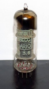

I’m currently using a pair of Miniwatt 18ECC, which I bought from Benjamin at Mojo Audio, because he said that these were his favorite tubes from his LTA modding days. Benjamin said he liked this tube because it had twice the plate area of a 12AU7 or 12AT7, which results in a more effortless sound and more dynamic by comparison.
I have to admit I didn’t really do much back and forth comparisons, because the MZ3 sounded just the way I wanted after putting the 18ECC’s in, so I kept them there.
It is a direct replacement for a E180CC/7062, can be used as a substitute for a 12at7 (but it has less gain than a 12at7), and in most cases can sub for a 12au7.

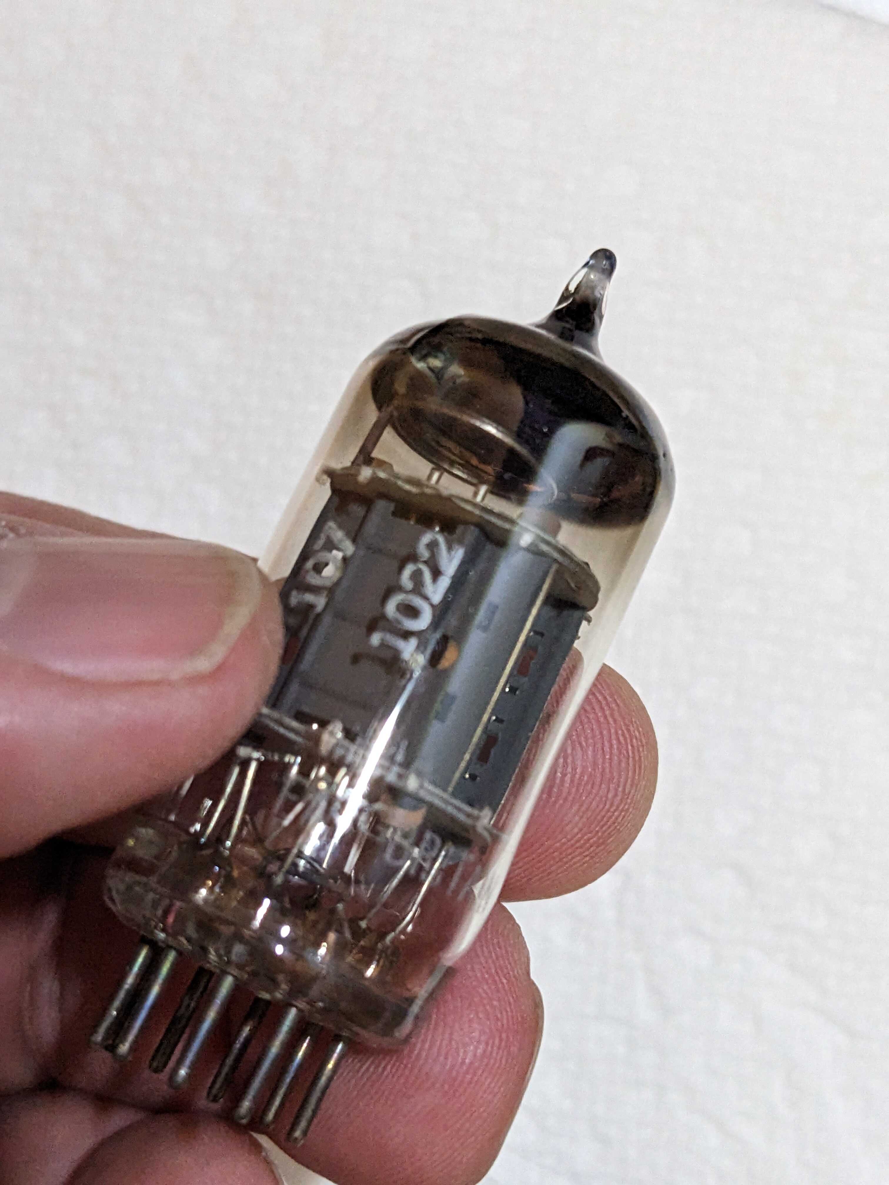

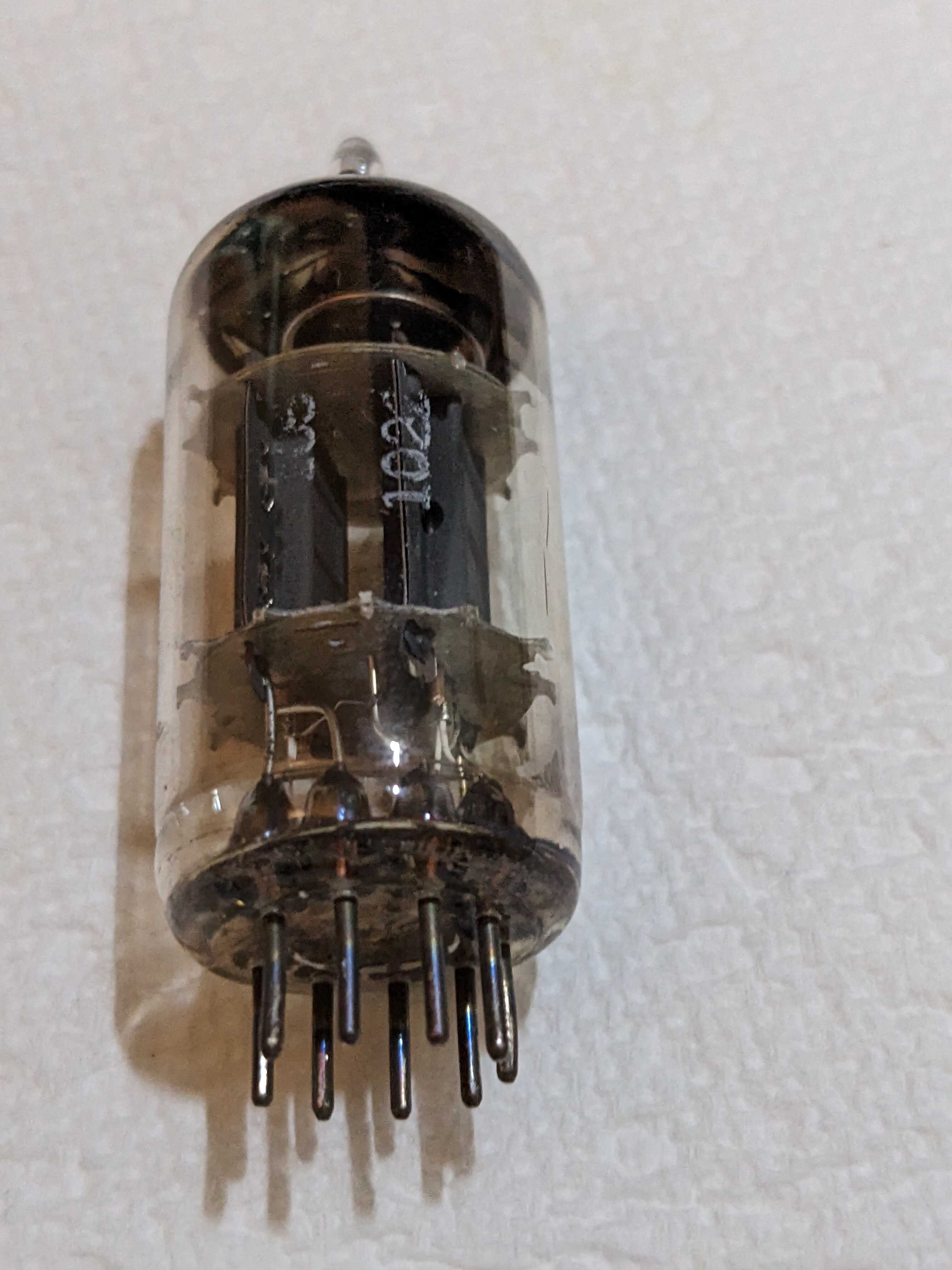

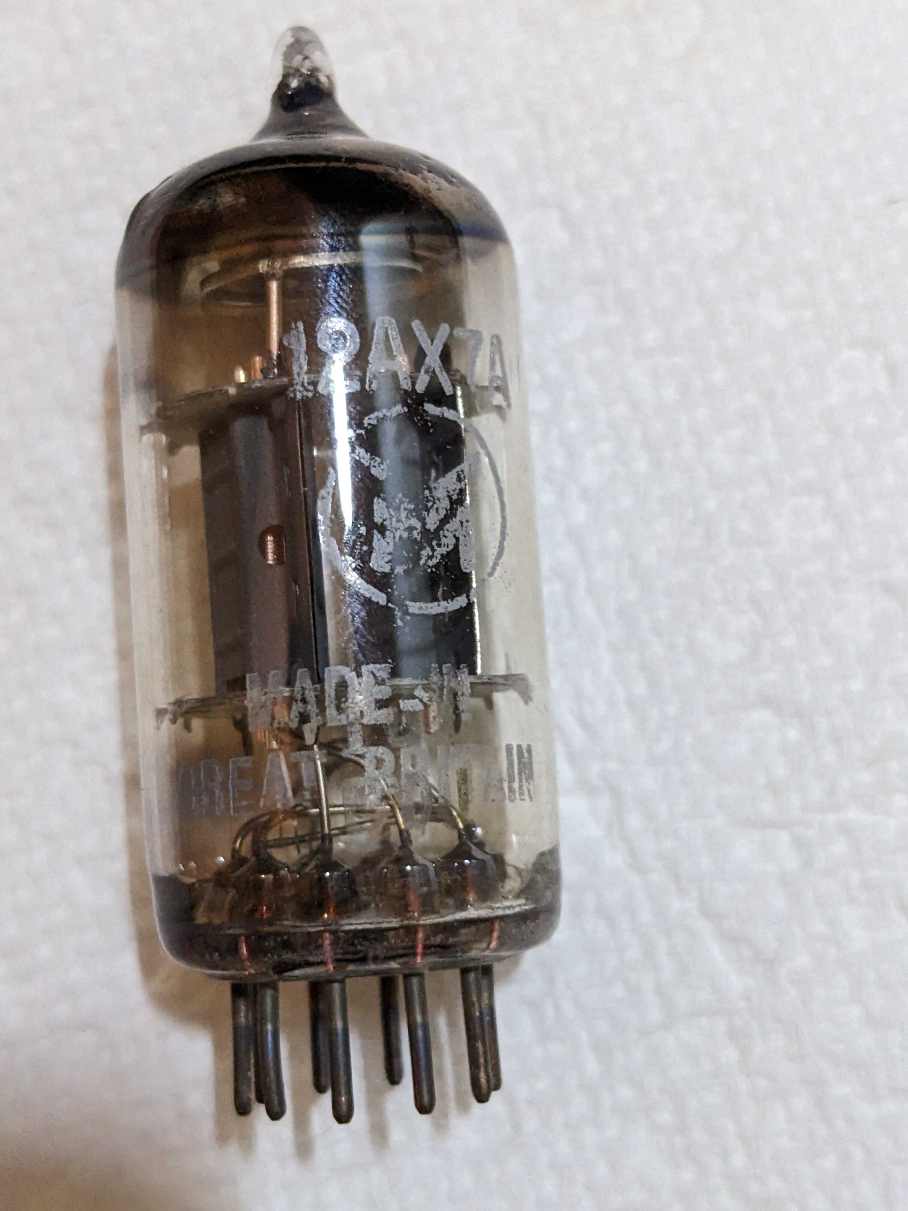

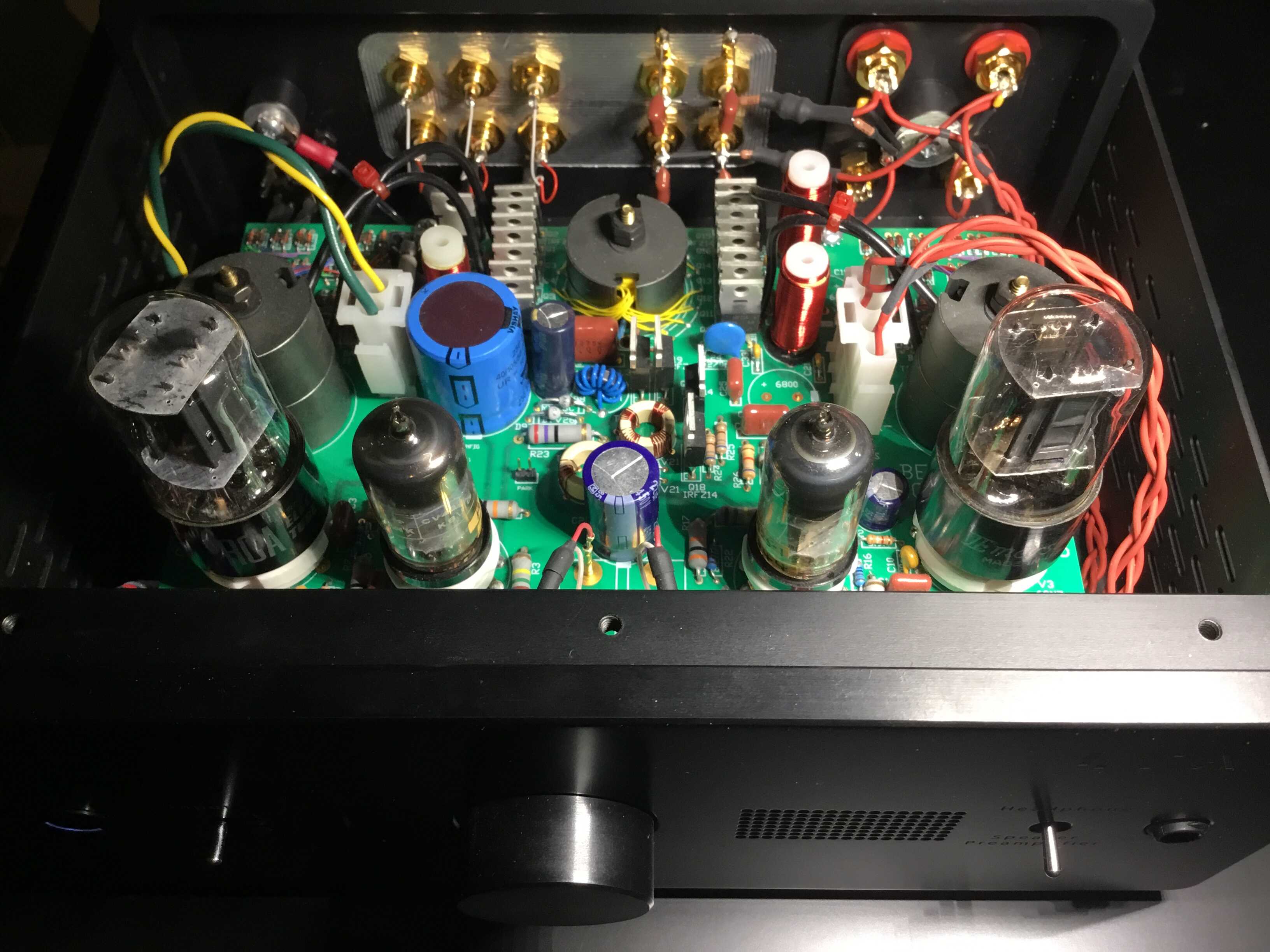

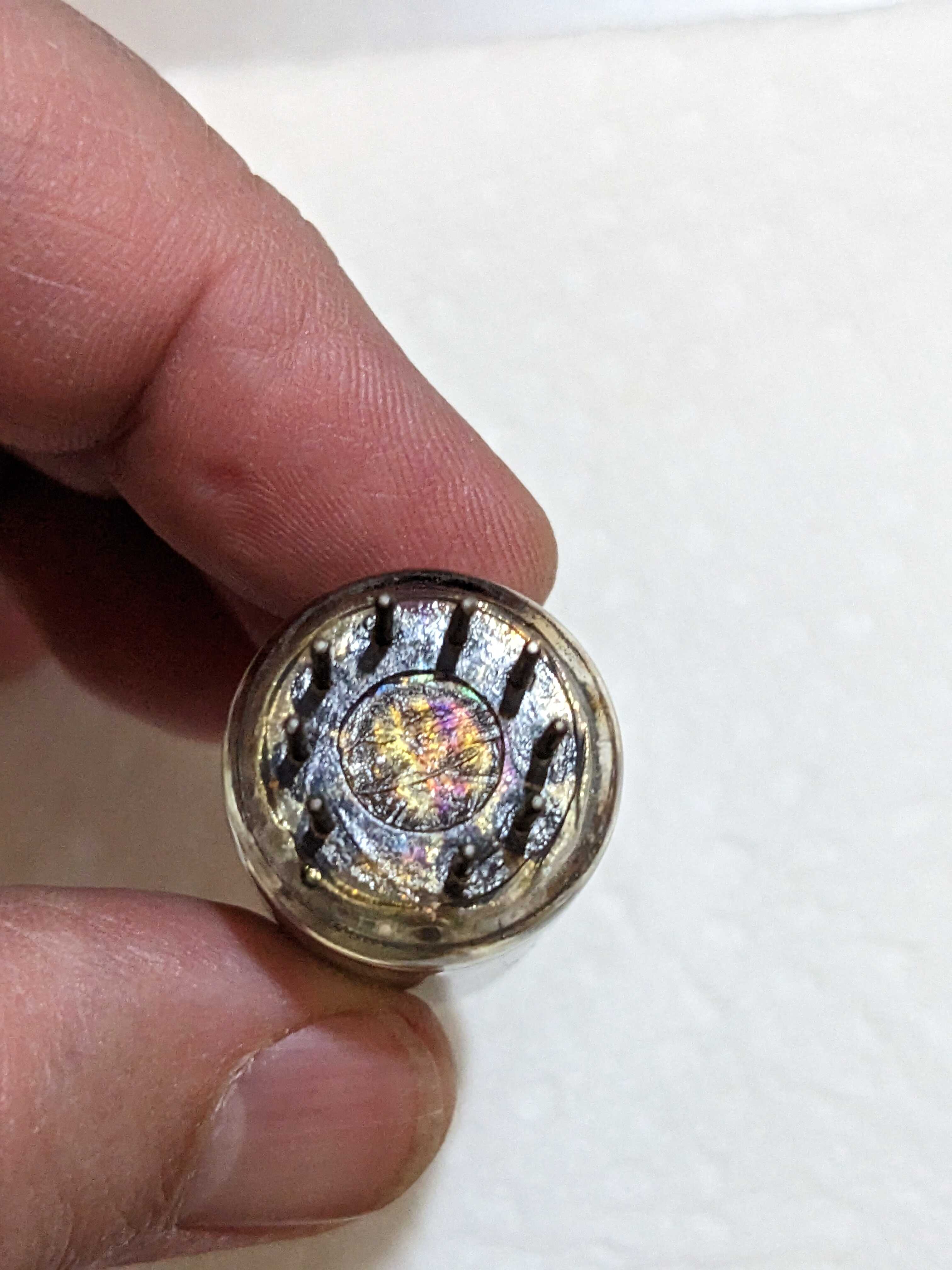

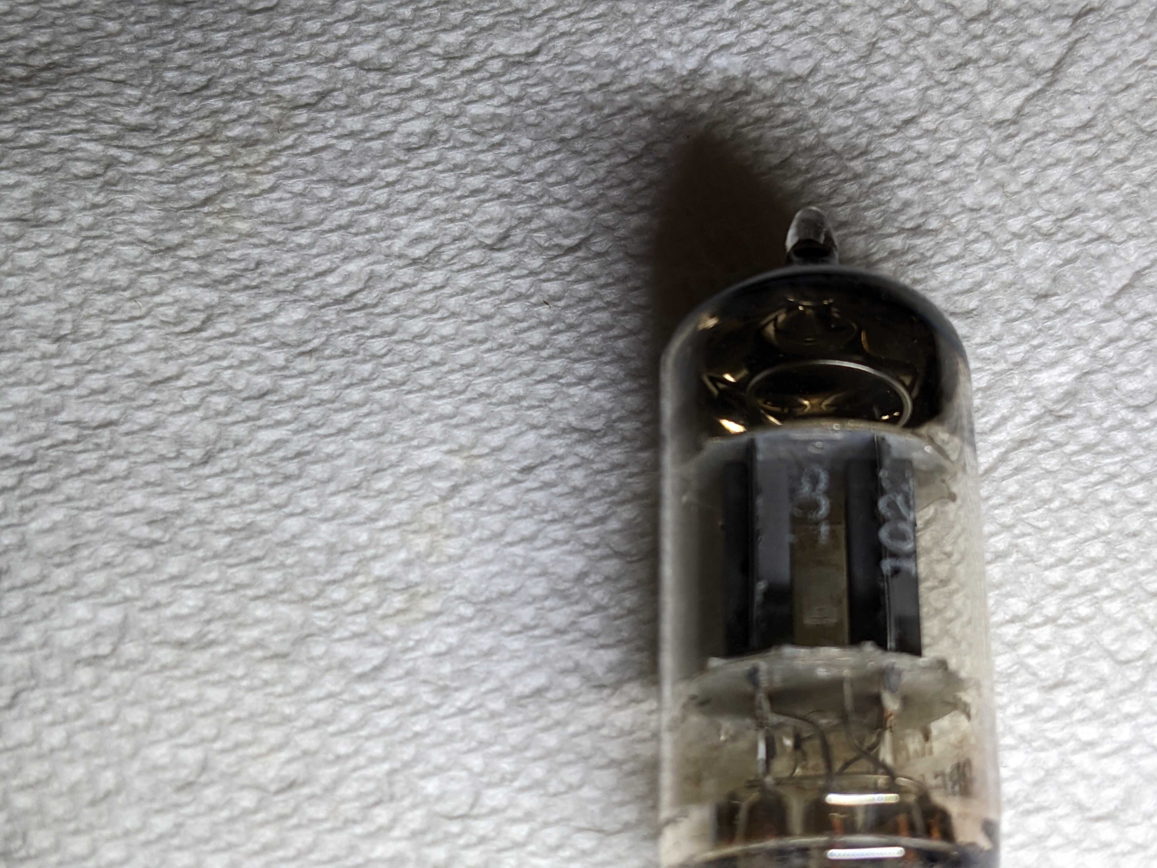

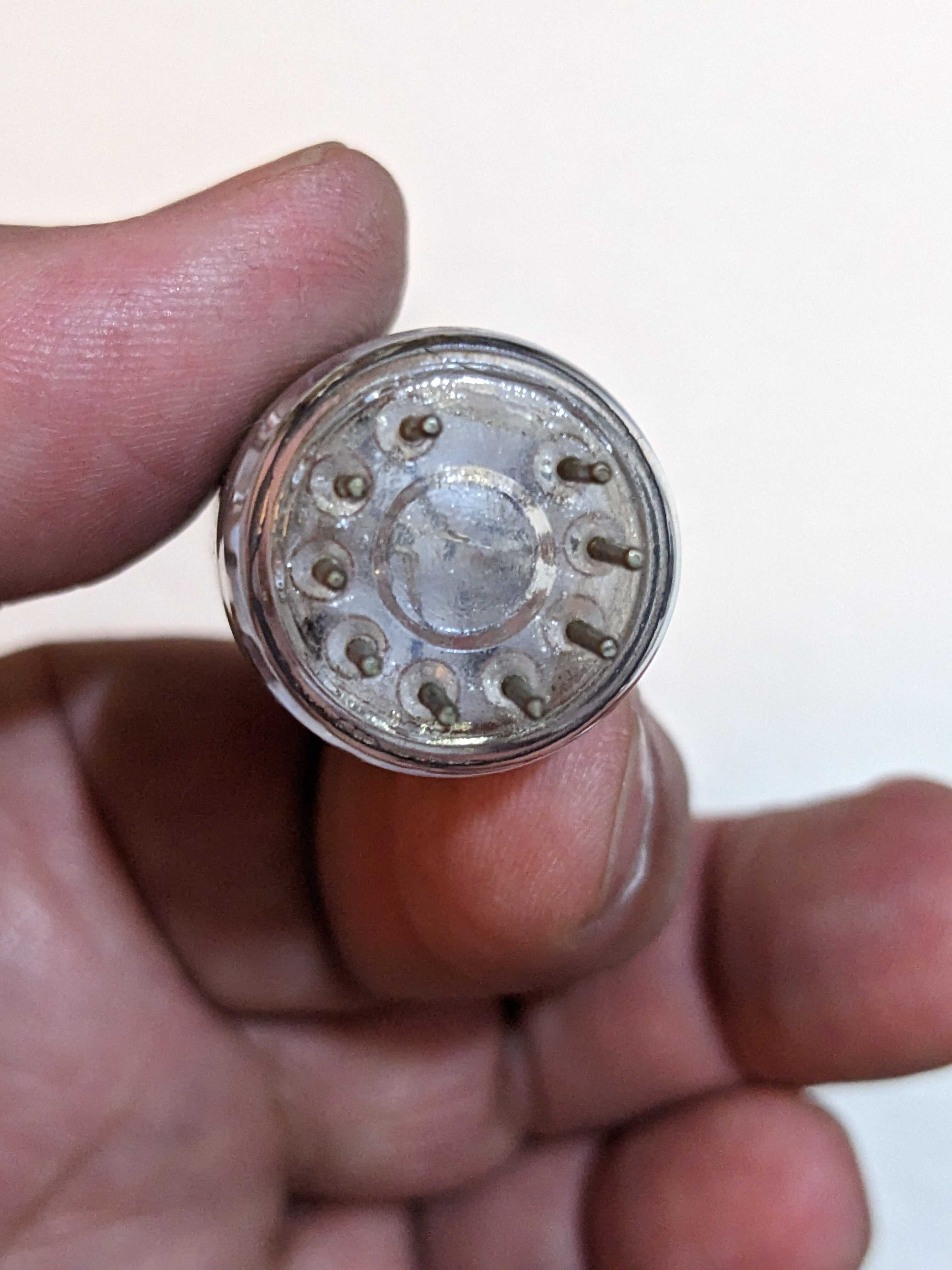

Based on that, I’d like to identify what’s there currently so I’m posting pics. Potentially @Hazi59 if you can point me to one of the multiple references you’ve made on tubes in the past if you’ve spoken or described their qualities somewhere. An suggestions on suitable tubes that may lean the sound one way or another based on what I’ve got here. Looking for top shelf recoomendations. :slight_smile:

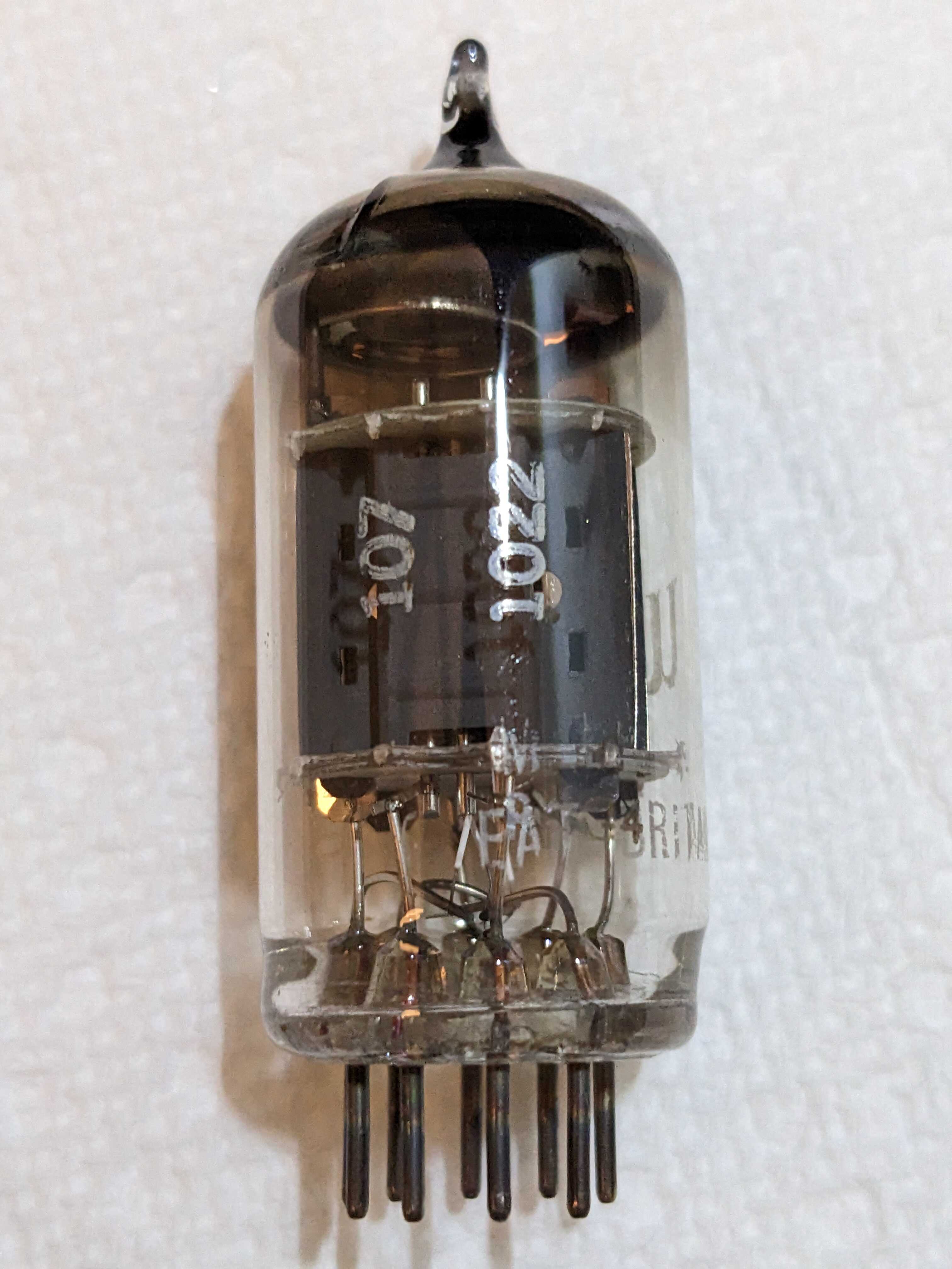

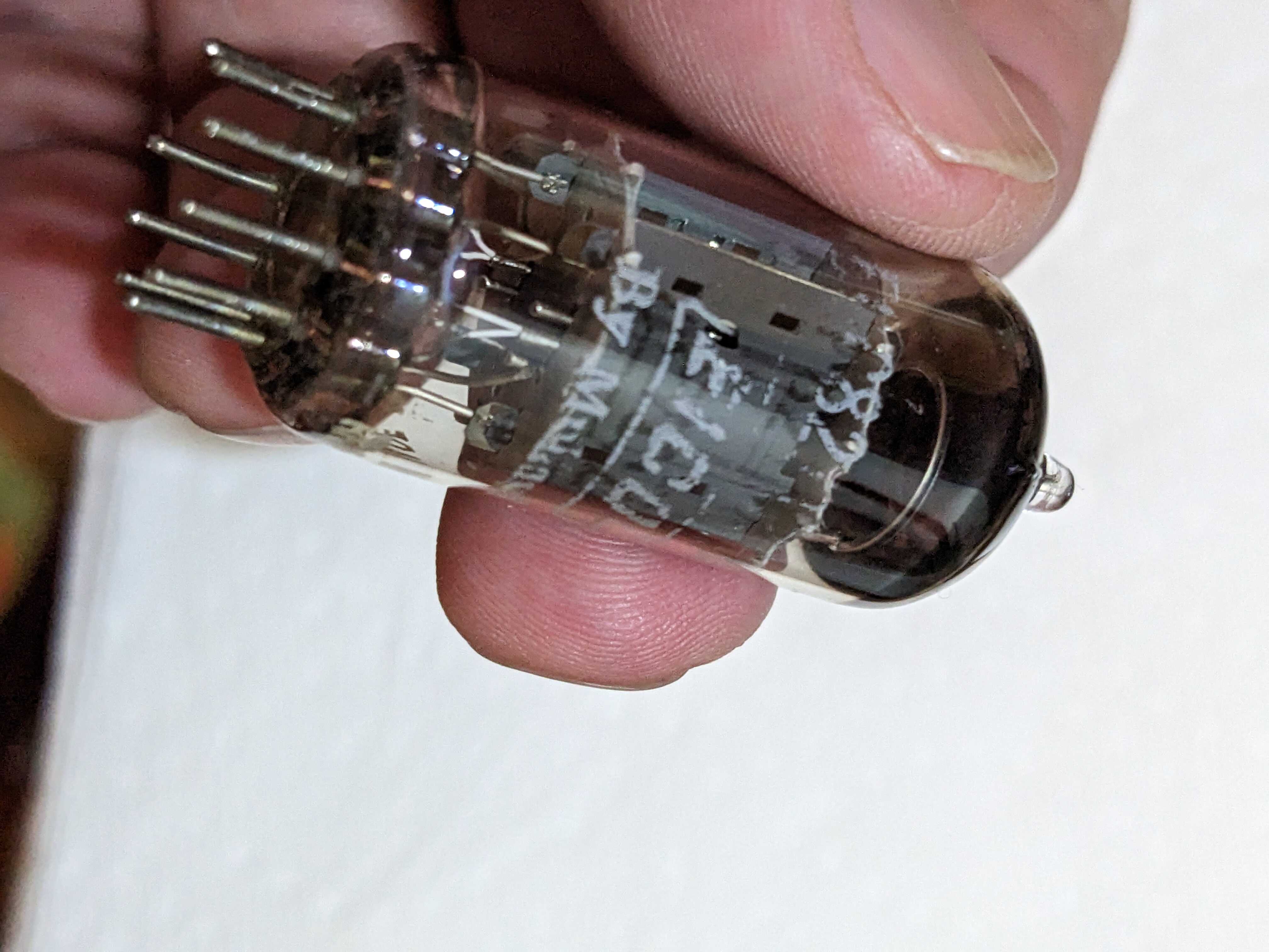

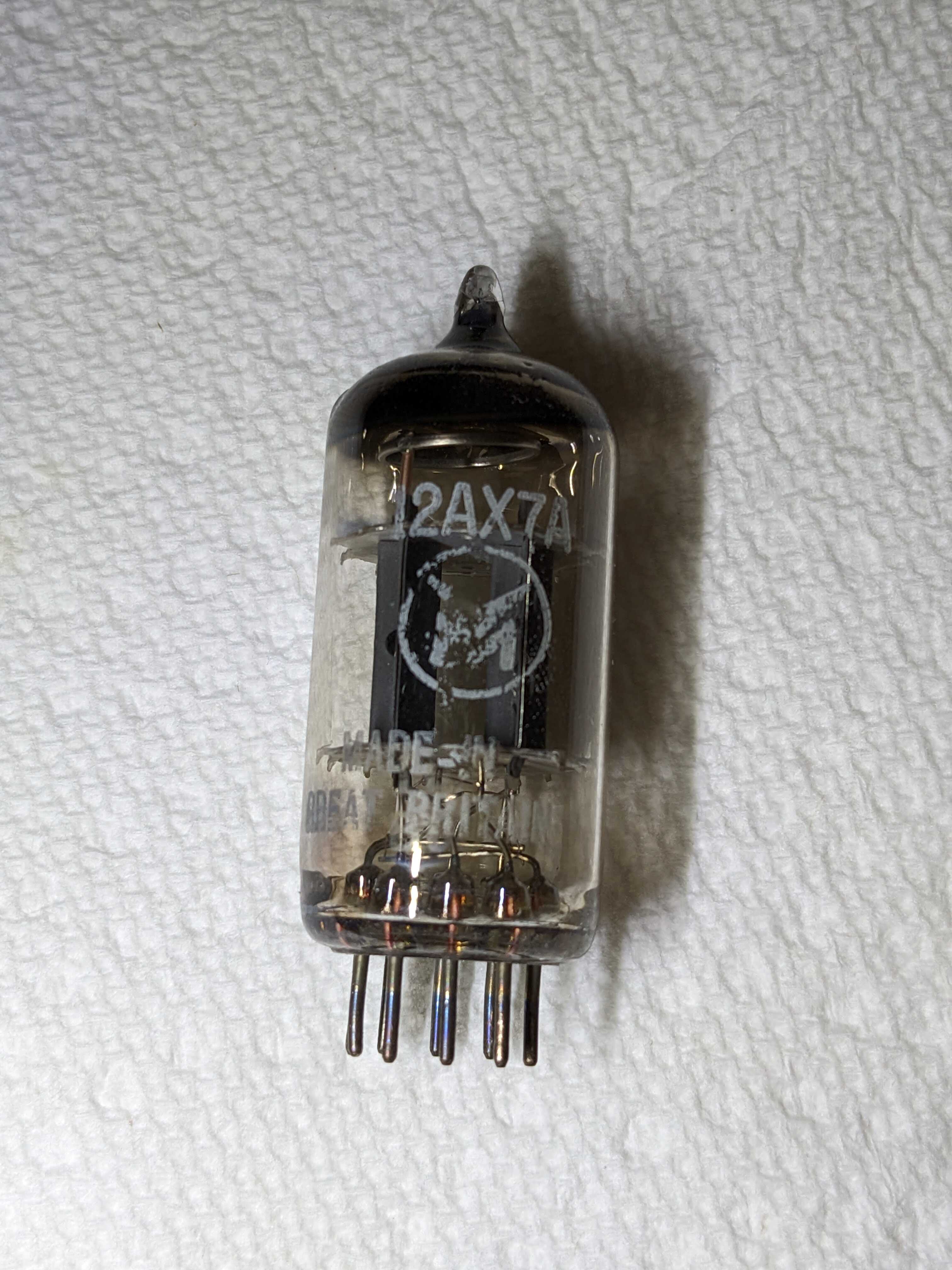

These are a pair of one of the umpteen flavors of Mullard. 12AX7 and they are a matched pair. A lof of the writing is worn off though so can’t even tell what the date code is. They are in the amplifier input section.

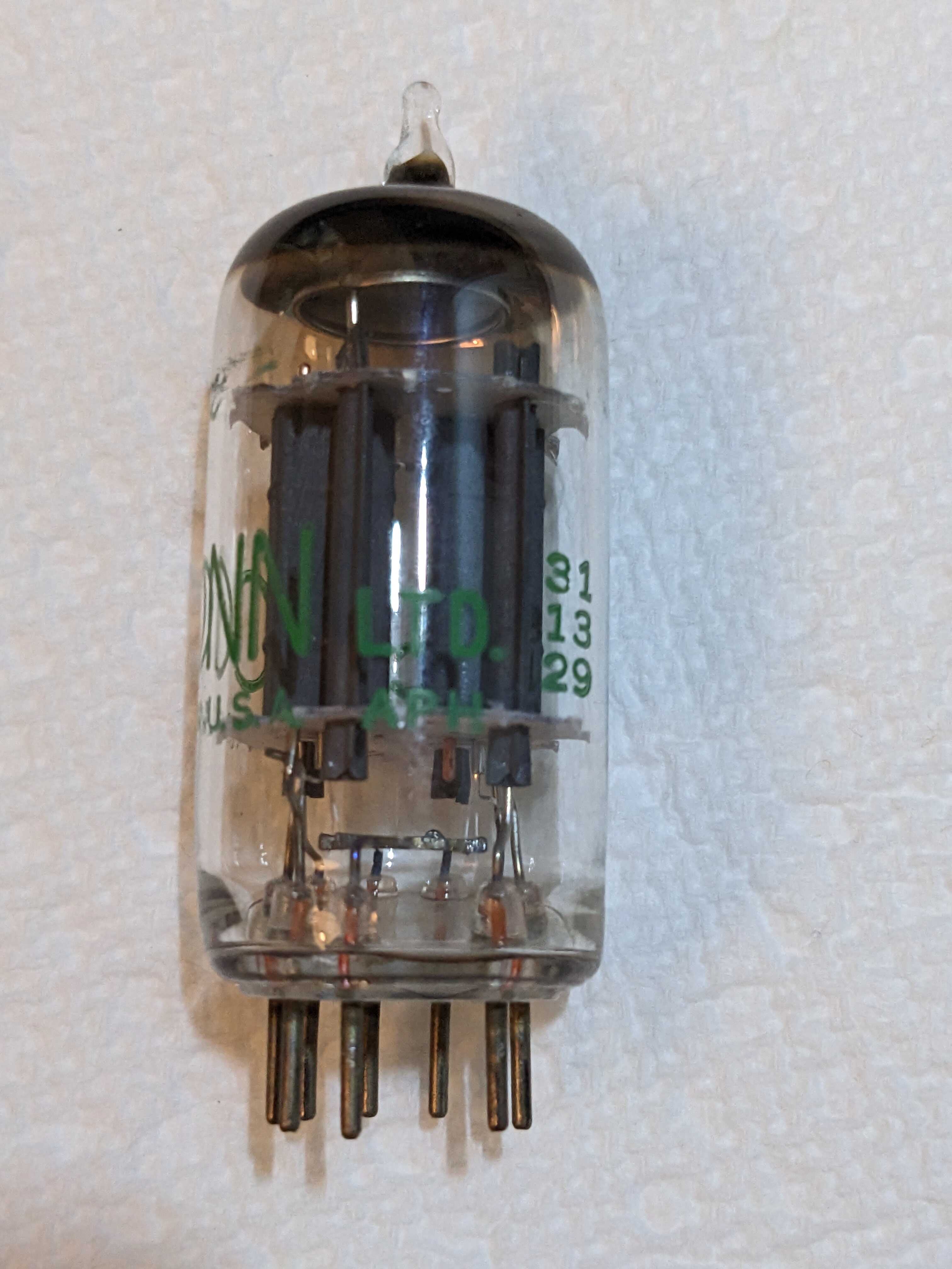

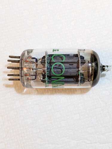

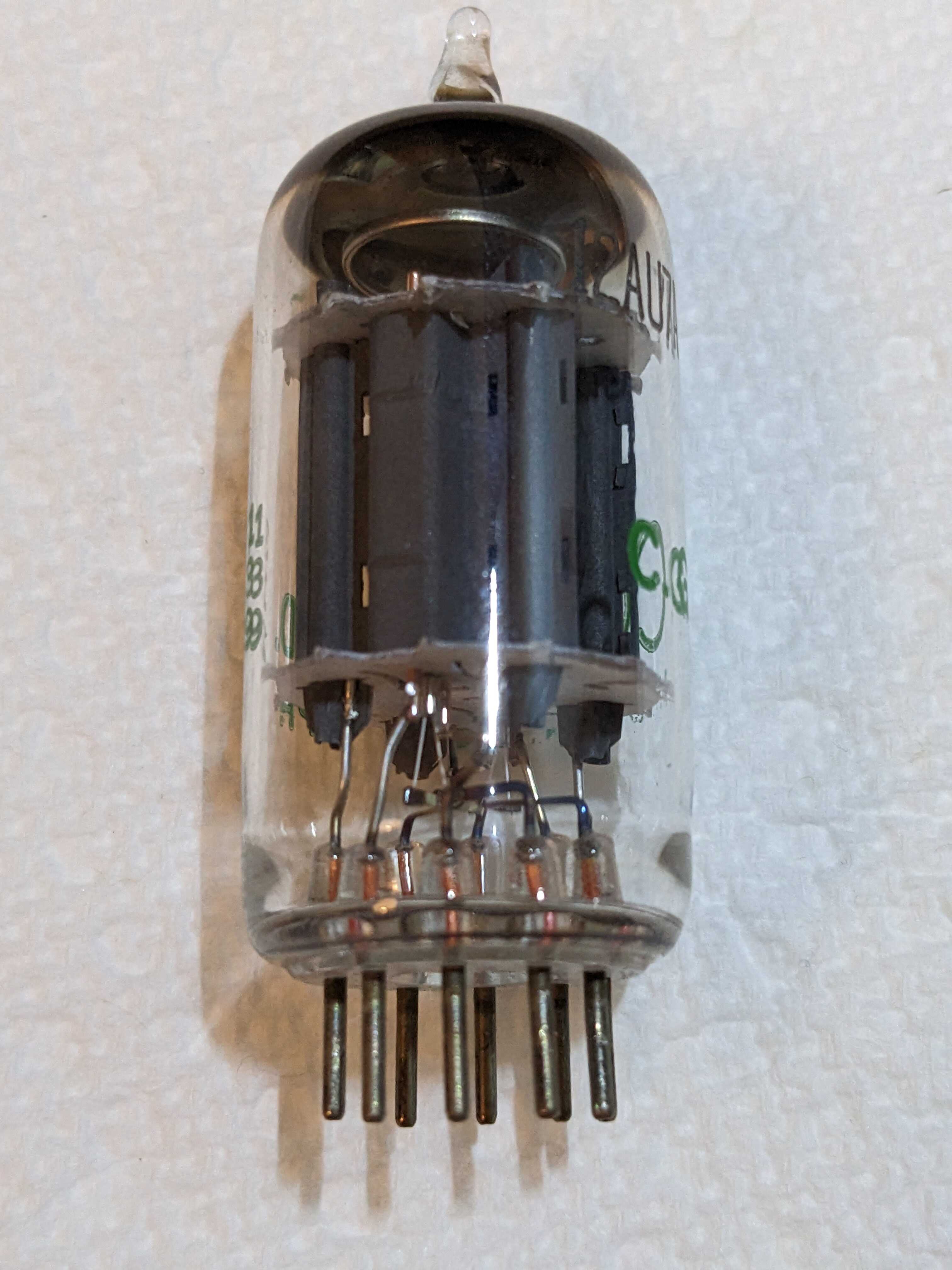

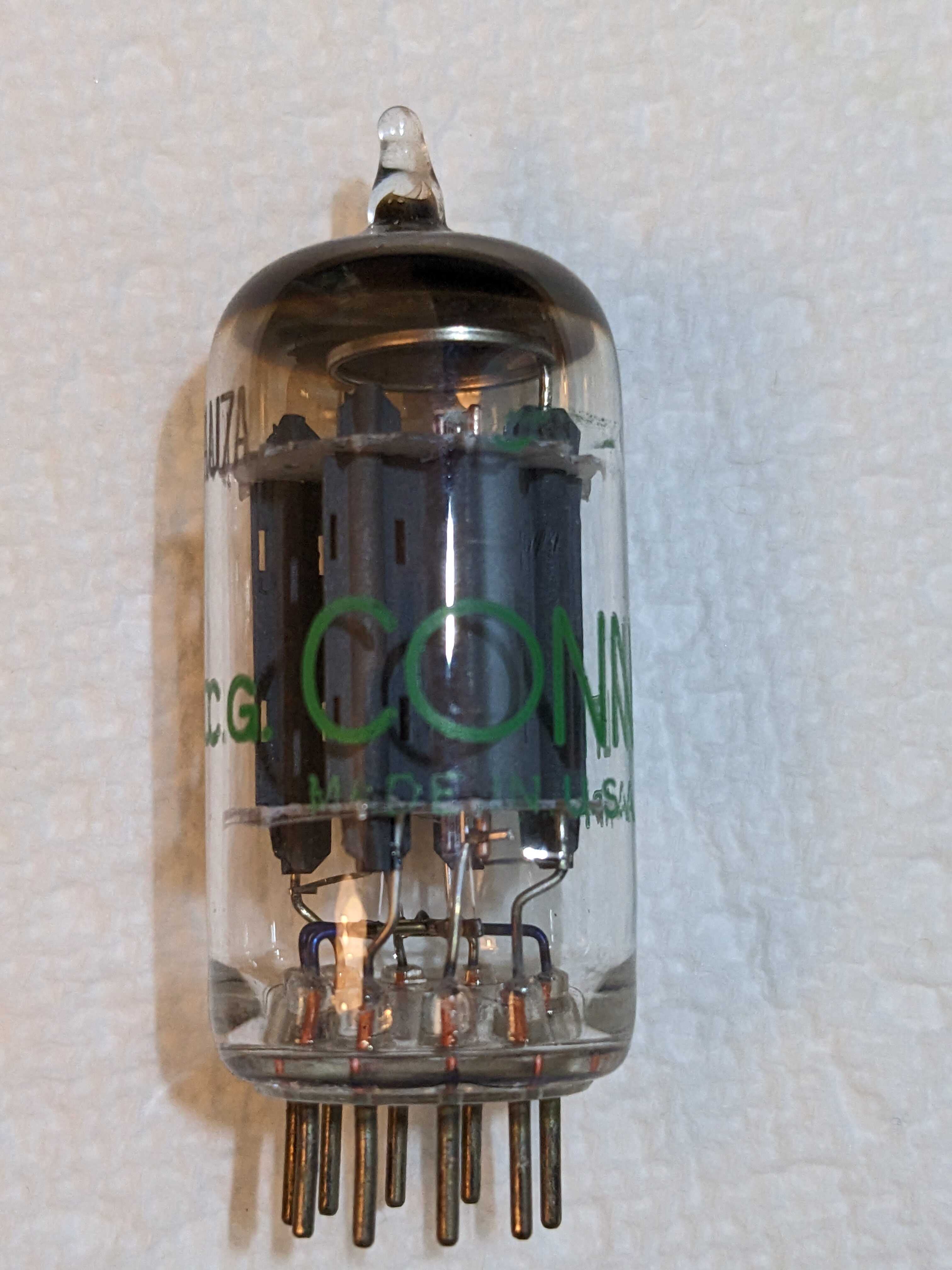

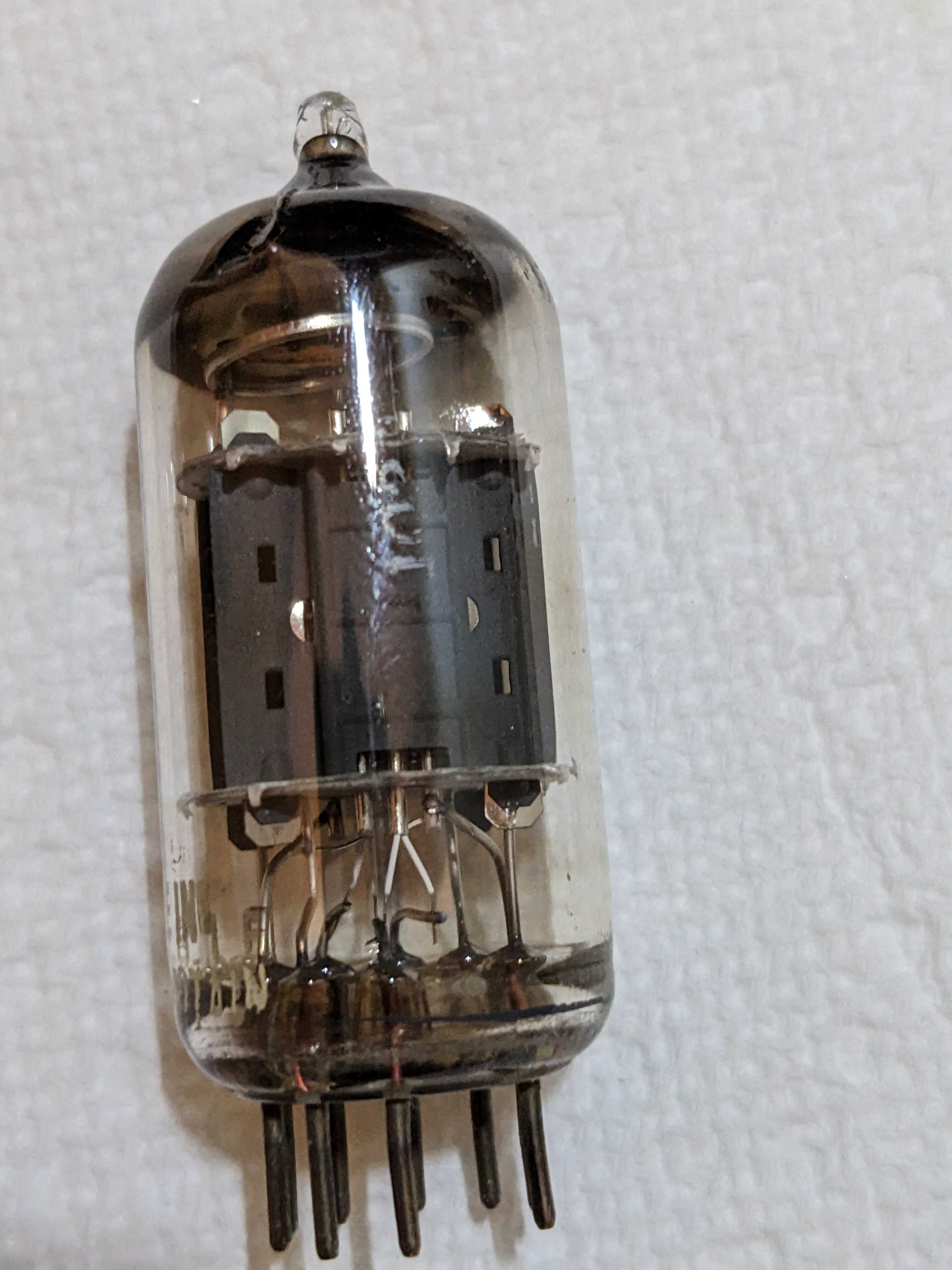

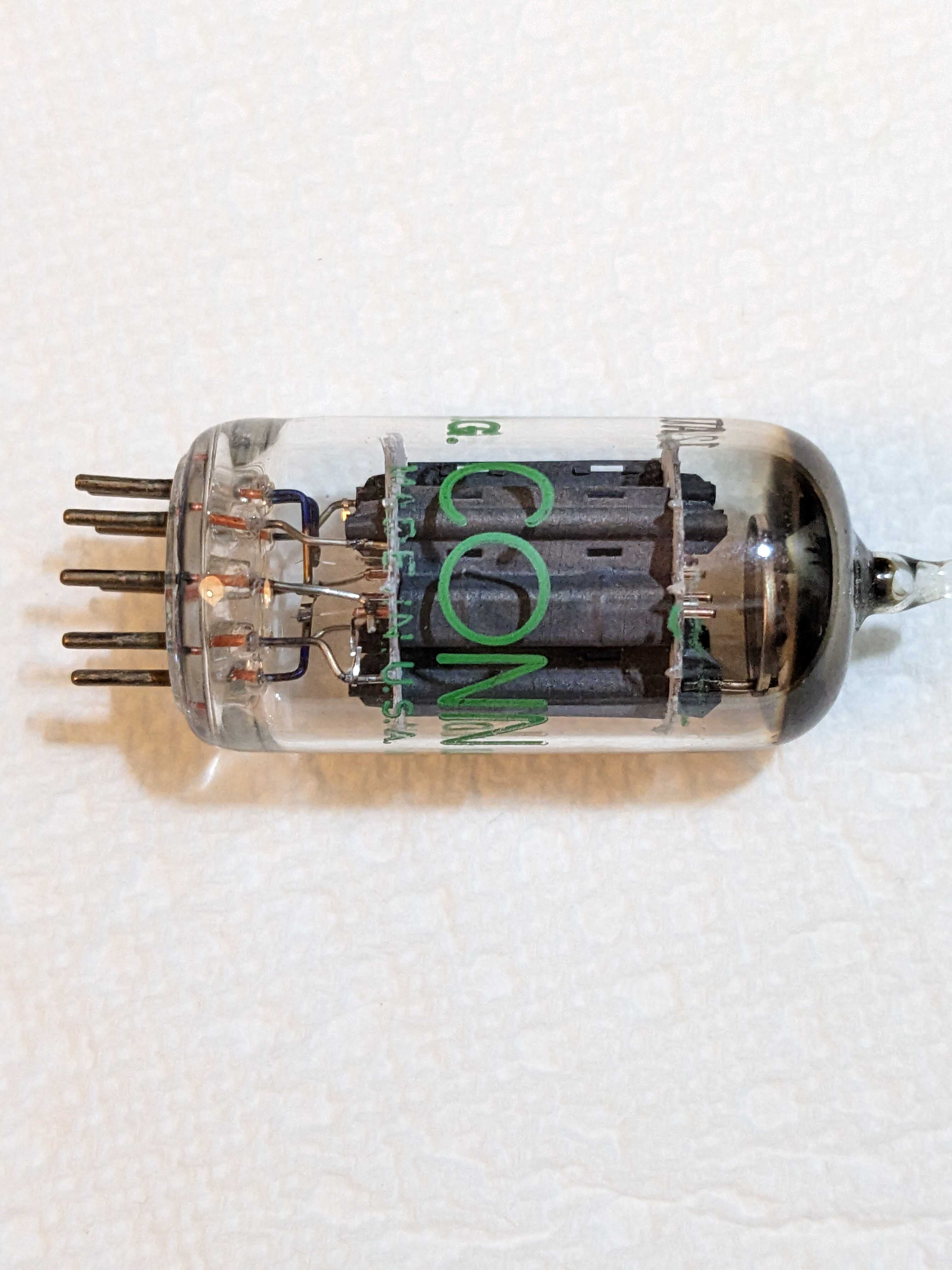

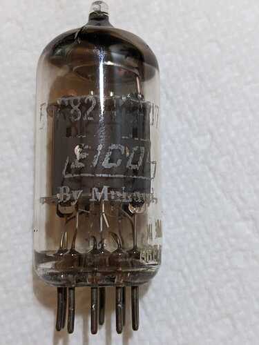

The next pair is also in the amplifier input section but they’re 12AU7. It’s also a matching pair and they have green label (perhaps from a 3rd party distributor so not sure of the manufacturer.

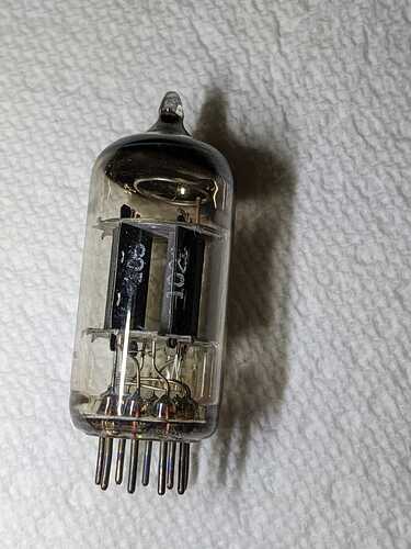

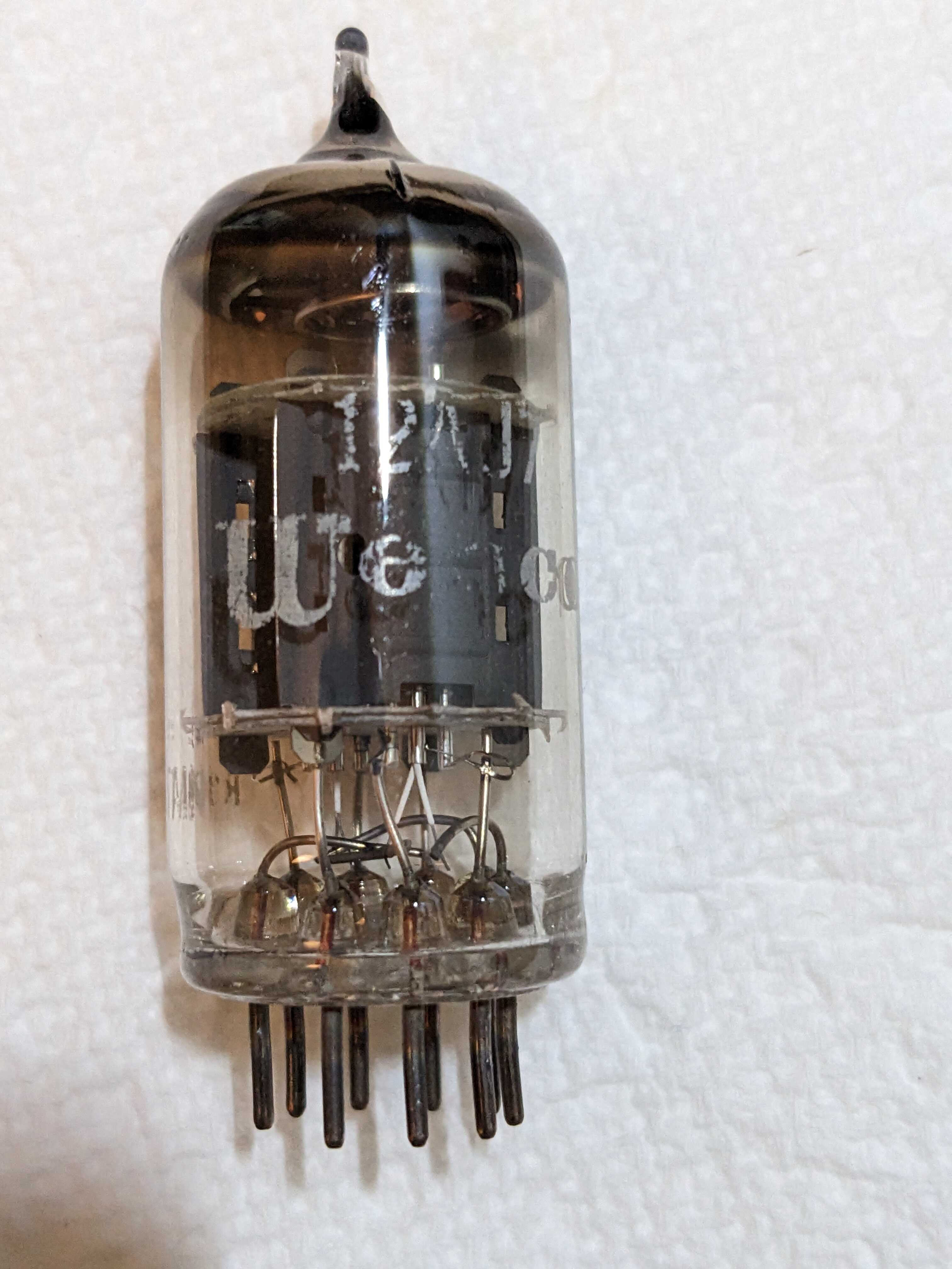

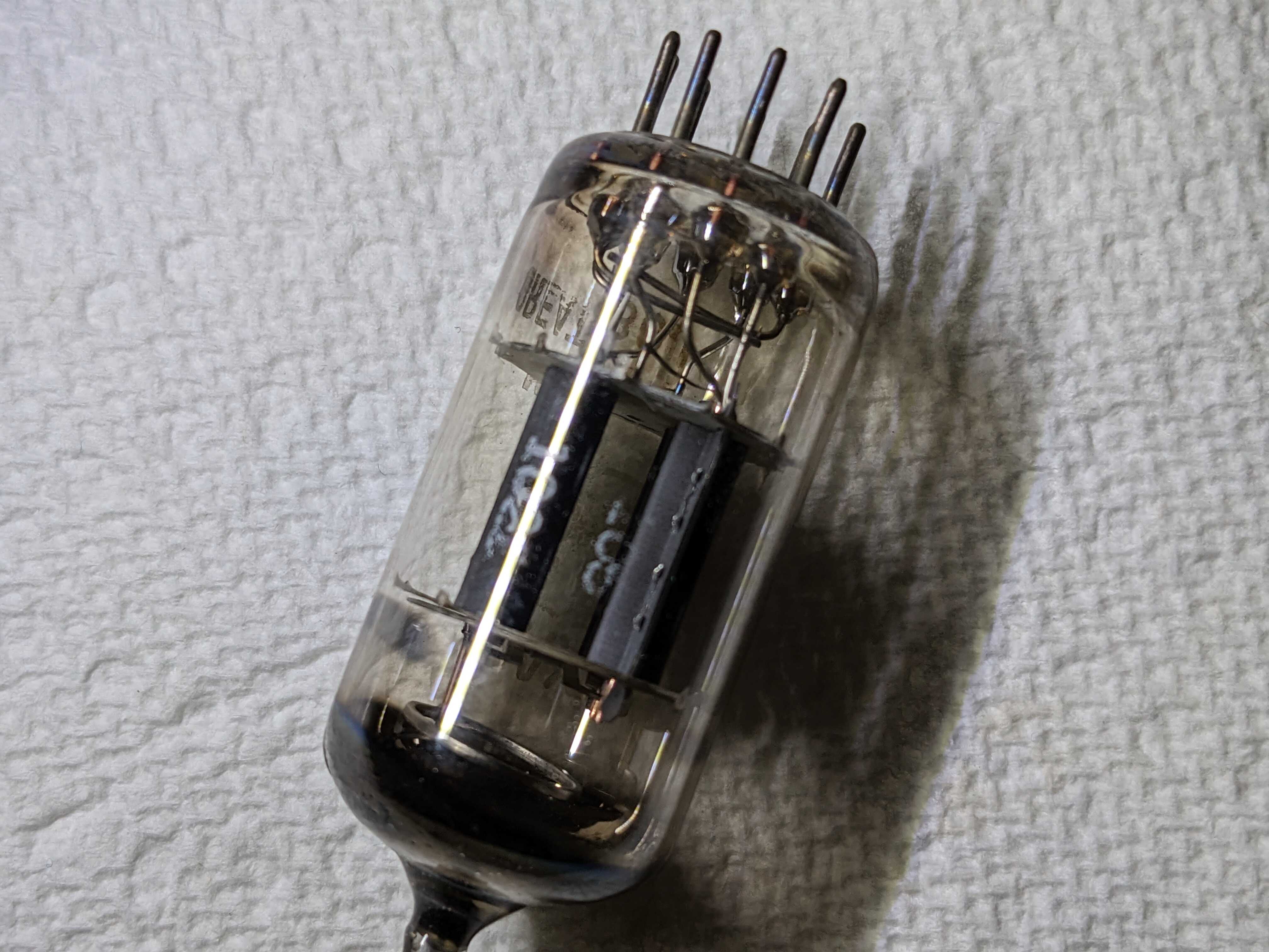

The last pair should also be a matched pair based on the manual but the labels don’t match. They are 12AU7 but they are used in the preamp section. Since the preamp board on the UL is vertical, they’re housed in a retaining mechanism with a spring and a an aluminum cylinder that twist locks. So way for them to move or dislodge during transit for sure. On one of the tubes you can see a Eico by Mullard marking. Made in GB.
The date codes on mullards are engraved into the glass, you can often read them, by rubbing some color into the engraved area and wiping it off. Fiddling with lighting until it catches the engraved surface can often help as well.
The only real thing to watch is that some late era tubes have engraved markings that don’t match what’s printed on the tubes, the engraving is ALWAYS correct in this case. As tubes got scarce, some distributors would re-label tubes with different markings for vaguely compatible tubes.
If your buying from a reputable source you shouldn’t run into that, but it’s worth knowing.

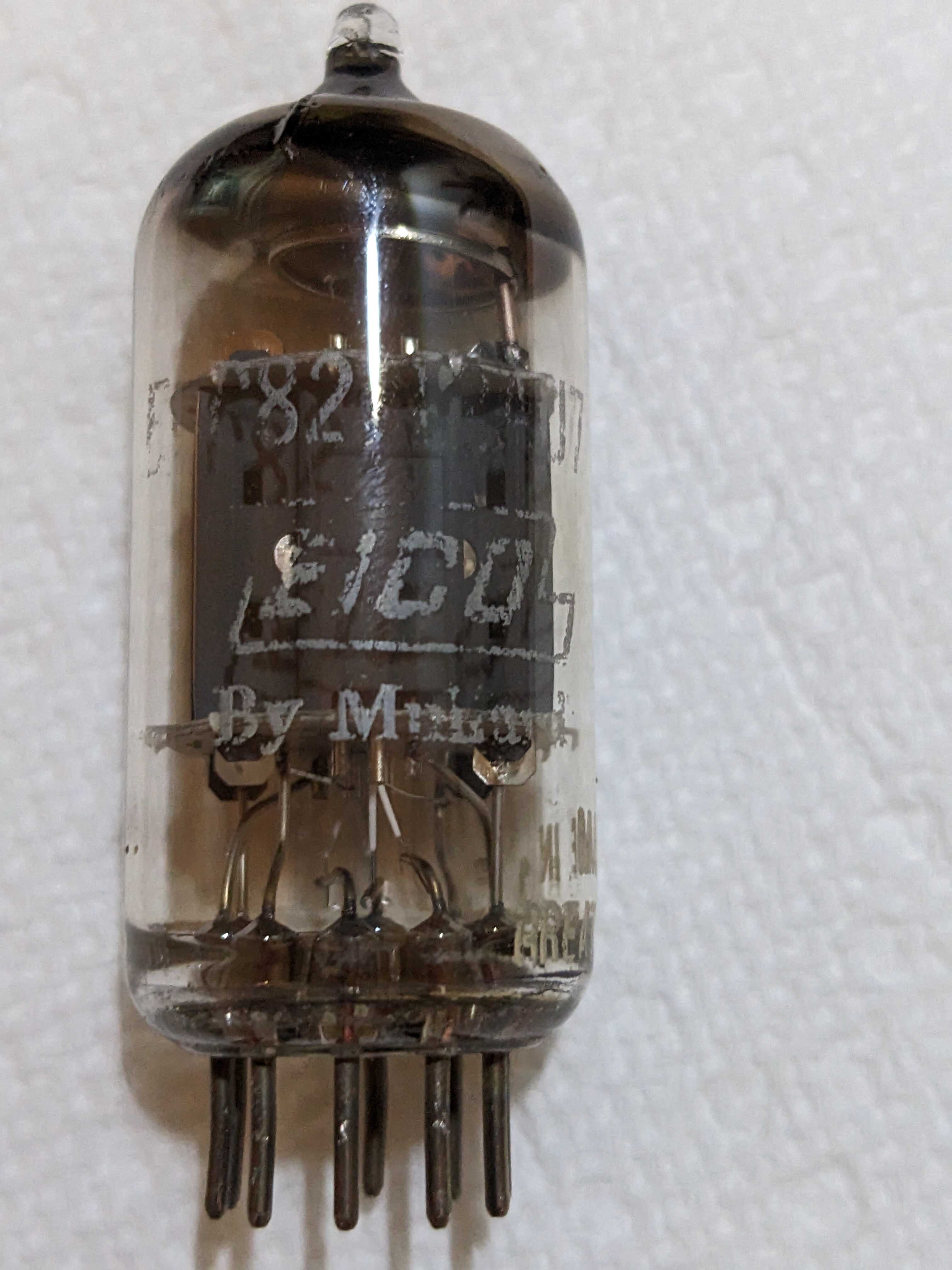

I have a rectifier with the same EICO by Mullard stamp. It is the '59 fat base i use in my EC. I love that rectifier!

I think the phase splitter 12AU7s are the least influential on the sound and you probably don’t need anything special there. hope this helps
This is interesting and to know. That’s where the green labeled CONN ltd tubes are. I think they may be Sylvania but I’m not fluent in the descriptors. Quite the cost difference so definitely will keep that in mind.

@dB_Cooper Your 12au7 with green labels look like Sylvania, because that’s what the 312 code normally means (you can see the vertical 312 139 in the second photo).
Here’s some info on how to figure out the lineage of your Mullard tubes, just in case they’re actually another Philips brand relabeled as Mullard, which isn’t necessarily a bad thing.
http://www.audiotubes.com/mullcode.htm
https://www.vivatubes.com/identifying-vintage-nos-vacuum-tubes-by-brand-country-and-eia-code/
I know they’re legit Mullards because they came from LTA, it’s my og set of tubes and they probably wouldn’t bother with nickle and dimeing that way. That said, it’s been pointed out to me that they’re not the “best of the breed” looking with some manufacturing imperfections so there’s room for improvement when I go hunting and I’m much better informed now.
Thanks community.
I agree, I wouldn’t expect LTA to nickel & dime, but that’s not what I meant. From what I’ve read (so this is one of those “I read it on the internet” stories, I have no idea of its accuracy), when Philips was contracted to deliver a certain number of tubes for export, and they didn’t have enough tubes from the contracted factory (let’s say Mullard Blackburn), they sometimes used tubes from another factory, but would still label them as Mullard. They would have all been within spec, so it probably wasn’t a big deal.
In any case, assuming they are Mullard, the codes in those links I provided will tell you which Mullard factory they came from, and maybe even which year, in which case you’ll be able to tell if they’re best of breed or not, e.g. a 1962 Mullard tube from Blackburn is considered better than a 1970s Matsushita tube from a Japanese factory using Mullard parts. Anyone who told you they’re not best of breed would have had to do the same research.
A rule of thumb for mullards is anything 40s and early to mid 50s is usually the best of bunch. Better if they were from a UK (blackburn) plant. Late 50s up to '59 are very close to this. Part of '59 to through 60s are when they started diversifying (philips, amperex, same tube and design, different factory and location, etc) still good but they tend to loose some of the real magic.
With most tubes, the earlier production the better. It’s like the manufacturer put their best efforts in for initial runs, then slowly cut a corner or two as the years went on. Ymmv if those slight changes made a difference or is worth the $$$.
I think one of the few that got better is the Amperex 6DJ8 and it’s variants, most because they made stronger and better tubes for airforce use. The late “flawed” pinch waist versions being very rare but supposedly one of the best. The pinched waist was a manufacturing defect but is said to give it tight and exacting detail while not losing the amperex magic.
