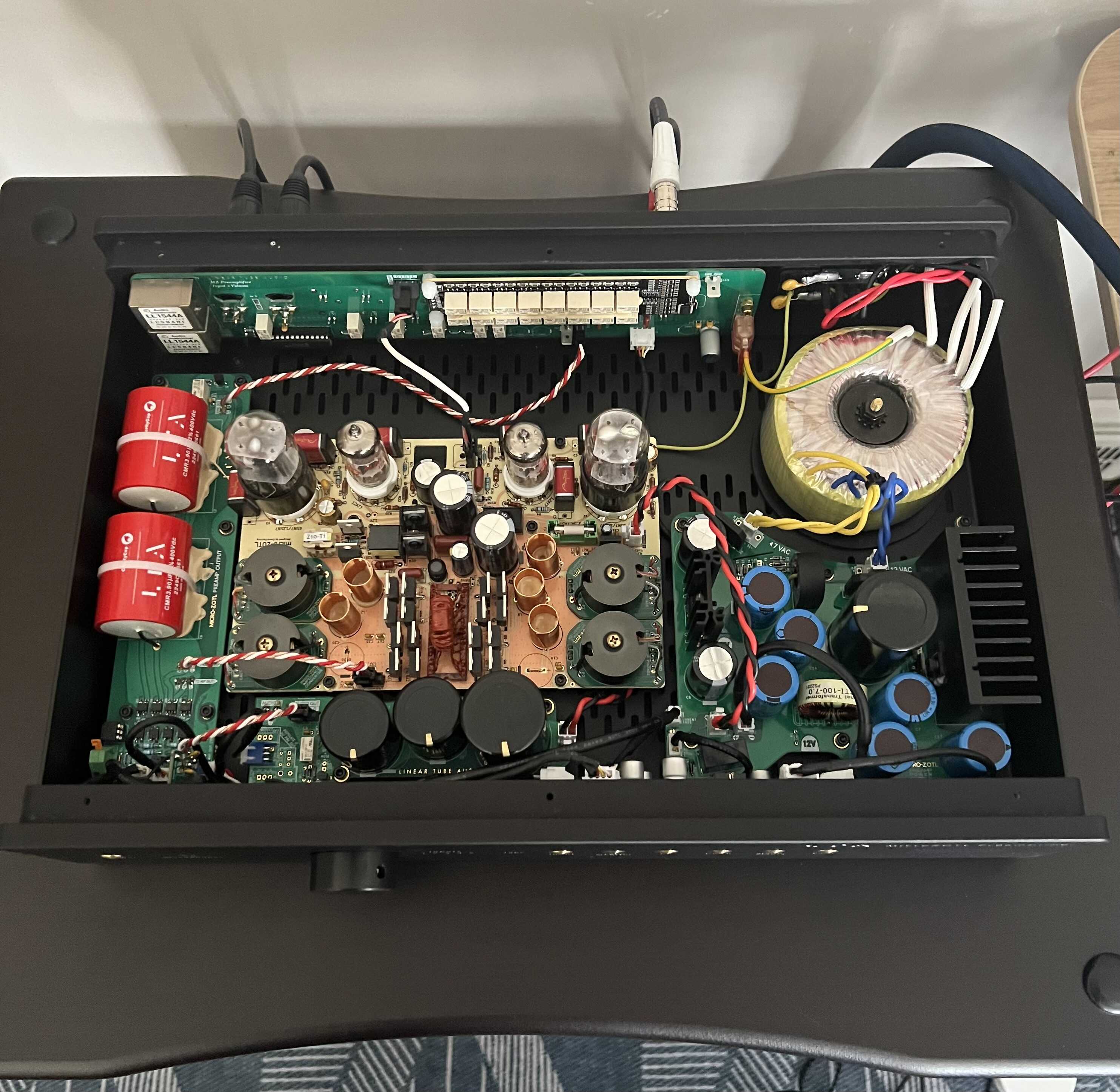

I had to send that preamp back to LTA due to some shipping damage or at least that was the guess on what was causing a loud amount of hum and hiss from it. I shipped it out Friday the 27th, they received it on the 30th, fixed it by the 3rd, and I had it back in my hands today, the 5th so a pretty quick turnaround. I’m attaching an internal picture of what it looks like now and the only visual difference I’m seeing is of the power supply board which has different color capacitors. I didn’t bother to read what they are rated for but I assume they are basically the same as what was there previously. In communicating with LTA, I worked with Jacob who runs their QC department and he said there was some grounding issue and that the main amplification board was replaced.

To turn it around for you as quick as they did, they probably just diagnosed it as a PS issue and changed that. If you look closely they also replaced the transformer.
Yeah could be, it doesn’t look like main amp board with the tubes was replaced but it’s possible. Jacob said they hadn’t experienced an issue like that before but regardless I’m glad that it is back and working now.
There are some things different in the components of the main power board so they did very likely change that, it’s not as obvious though, just the aligned angles of components.
