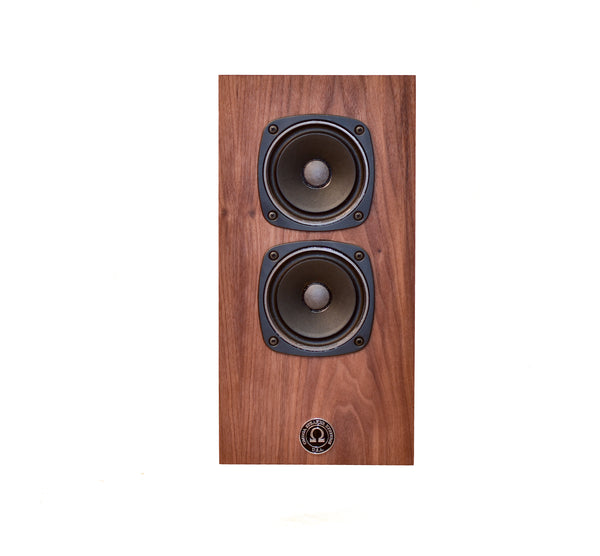

So the front runner is definitely the Omega Super 3 High Output right now for a good efficient and not gigantic desktop speaker. Although the Lii Song Emmo Fast-6 has piqued my interest a bit @NickMimi is there anything more you can tell me about these? First hand experience?
has anyone heard the Omega K8? or seen impressions of it somewhere? This honestly seems like it would be perfect for what I want.
EDIT: I just sent Louis at Omega an email, to see what he recommends and get some advice and more info on the K8. From what I have gathered so far the K8 is a newer offering using their 8inch paper cone full range driver in a monitor with a front loaded bass port and has 92db efficiency. seems like they really only started selling them at the beginning of the year, they have been posting a lot of pictures on their instagram
Looks like they’re 92db but that should still be plenty. They look great!

Oops you’re right, it’s the super 3 high output monitors that has 98db :grin:

The smaller, more sensitive Omegas, w/ the 4” driver pair seem to be a good choice :man_shrugging: overall w/your equipment, based on build, specs, design etc.
