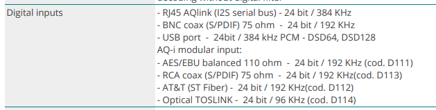

edit: this is for Aqua La Voce S3
Is the 75ohm / 110ohm thing something I need to keep on the back of my head? Or are all of them already set to that spec?
And is the bnc coax the same connector as the rca coax?
The connection impedances are standard but you need to buy a digital cable rather than just use a standard RCA or 3 Pin XLR.
They’ll work if the impedances don’t match, but it will increase Jitter marginally.
You must 100% be vigilant about it. they are very specific. 75 Ohm for RCA and 110 Ohm for AES. And you’ll find specific COAX cable, no substitute.
just in case the question was also about the physical connection, no it’s not, BNC coax to RCA coax will require an adapter. BNC usually locks in place, better fit.
