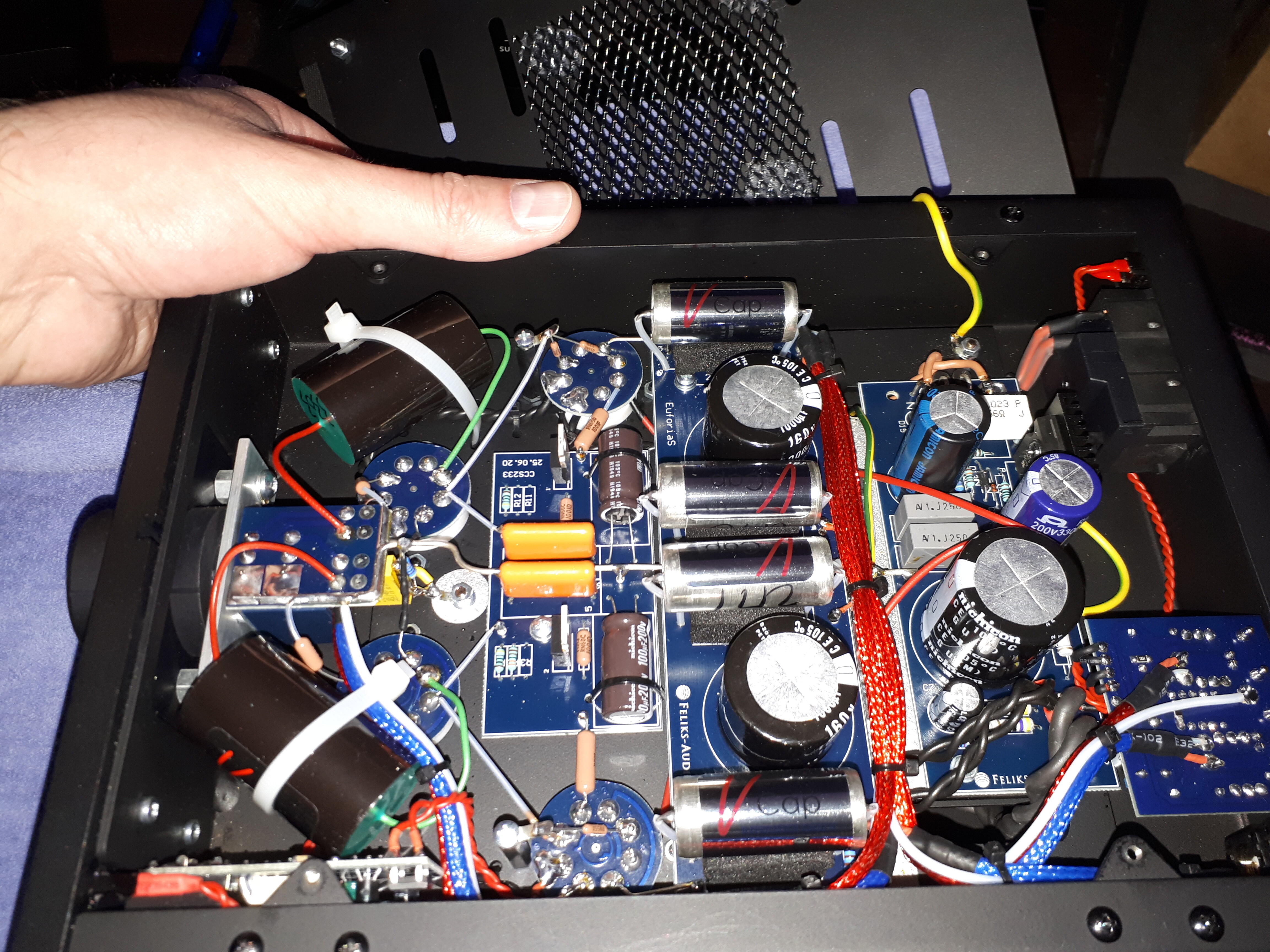

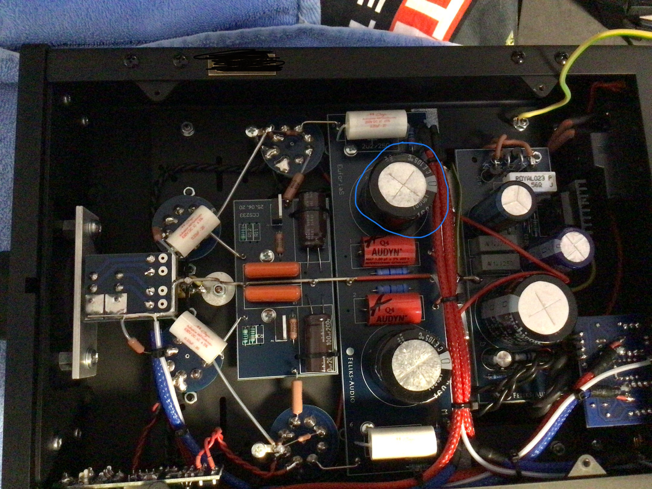

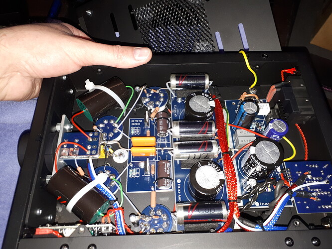

Hello,
Yes, you’re right.
You will probably never find an Euforia to buy that has different capacitors.
If you did, it would be luck.
I did it on my own initiative, what I could do myself I did and it was not difficult.
The Odam rebuild was a bit more complex so I had it done.
But it was worth it.
To try and keep it short though.
As you said, the Otl reacts strongly to components.
I can only agree with that.
The replacement of the 6SN7 socket alone was a real leap forward and made the Mundorf look old.
I have only profited from it, the sound has changed for the better, with the Lcd2C it plays much better, I can put aside the hunt for expensive tubes.
And I had a small problem with the Euforia and Lcd2c, especially in the treble range, that it occasionally distorted, which has also gone since the conversion.
It did have one disadvantage and that was the wallet.
The disadvantages of the Otl are a good question.
Certainly the implementation is important, bad or less good components.
My impression after the conversion is that before the conversion I needed better tubes to achieve the desired result.
After the conversion it is rather the other way round.
I have been able to find a few good bargains on Ebay and the like.
6SN7 Nec currently sold at Sophia Electric as a limited edition for $200 each, the pair for $60,
Hitachi Ultron,Westinghouse 50-60$ a pair all quite excellent tubes for a round clean full bodied sound.
For the 6as7g sockets, the 6080 Csf Thomson is my favourite at the moment as well as the Svetlana.
The Svetlana more after conversion to Odam.Depending on the 6sn7 tube it can be snotty to smooth with it,to a miserable long low end.
I actually saw the Euforia as it is now when I bought it a year ago.
Of course it wasn’t planned, it was more the impulse that led from one thing to the other after the conviction it had to go one step further.
It doesn’t have to be the Vcap, there are other capacitors that are better than the Mundorf.
But if you like the basic sound, which could be better with more power, more depth, better vocal imaging, then the Vcap.
Here is a picture of it, I also changed the preamp output to Odam.
Before: The blue circle means nothing
After with Vcap:
