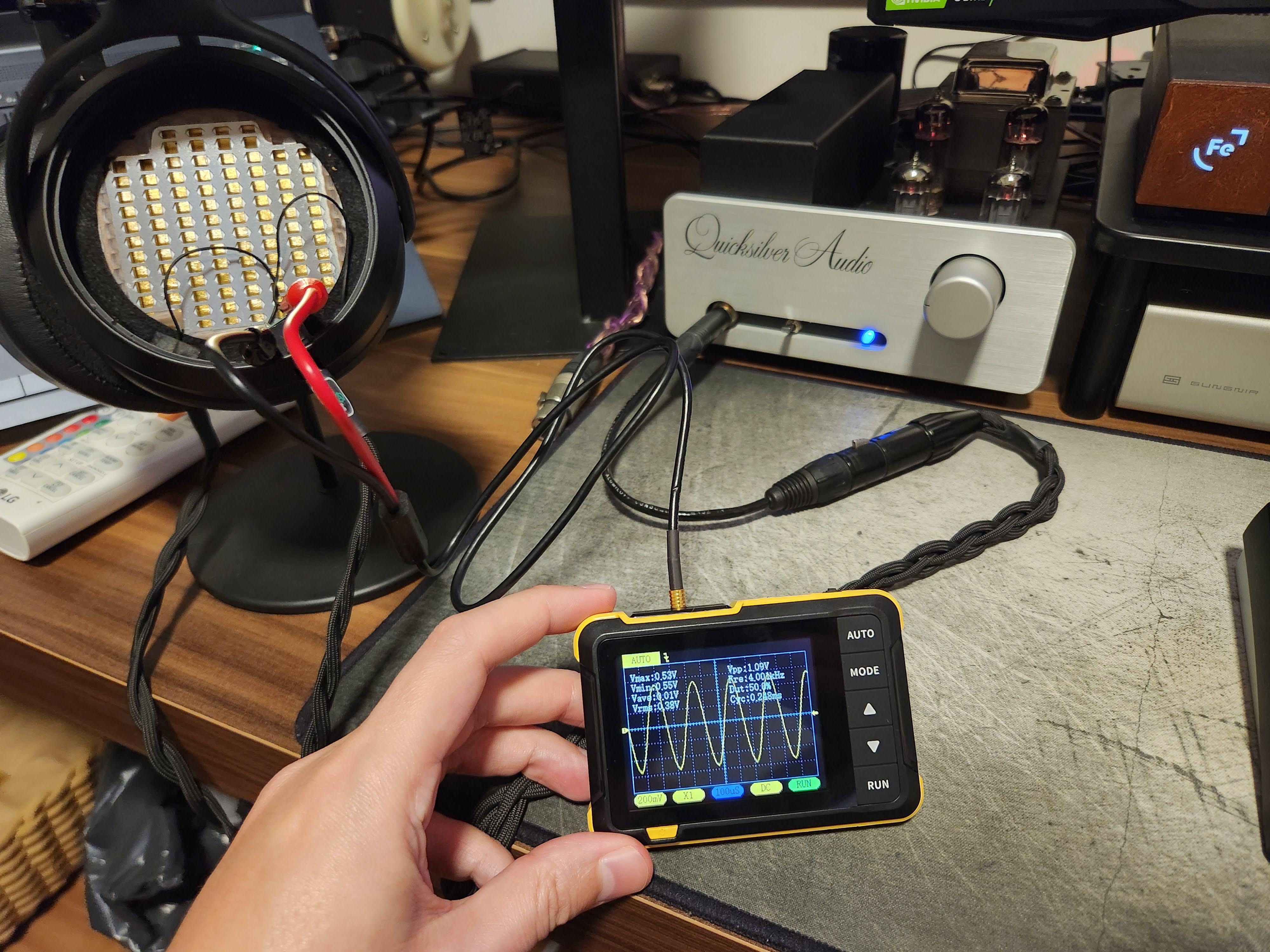

Hey guys, i got myself an osciloscope so i can determine at which levels of pre-gain my amps will clip for each set of cans.
Now that i can measure that, i wanted to understand how to best use this tool, here is one example:
The Quicksilver clips at 3:00PM on the volume pot when connected directly into my DAC, if i use a pre-amp i can increase the signal and then it will start clipping at 12:00PM and i can also decrease the signal so it will not clip at all even if i max out the volume pot.
My question is, what is the ideal world here? Should i set the pre-amp so it will eventually clip at around 3:00PM in the volume pot? Or the ideal thing to do would be to set the input level so it will never clip?
Doesn’t matter as long as it doesn’t clip at the volume your listening at.
Slightly more complicated answer, the pot position has no impact on what the quicksilver is outputting, BUT your preamp if it’s tube based it will introduce more distortion, at higher output levels. That may or may not be desirable depending on the preamp and your preferences.
One other caveat, generally at maximum volume pots are kind of shorted out, in that it’s basically a metal to metal contact vs something travelling through a coated plastic or carbon strip. This can be preferable, in some cases BUT you’ll also be minimizing the coloration from the preamp when you do that.
Short version of longer version, listen and pick what sounds best.
Thanks for the reply!
So, in a scenario where the amp clips at 1:00PM and i am listening at 12:00PM, is it still possible that when there are big dynamic swings i will end up reaching the clipping zone? Or that is now how this works?
What i am trying to understand is, should i pay attention to how close i am to the clipping limit? Does clipping apply to the headroom as well?
Not if your measuring with a sine wave that corresponds to the peak input signal.
Basically if the source voltage exceeds the maximum voltage the amplifier can put out then it clips.
If you test from the source with a full dynamic range sine wave your looking at the worst case.
With the caveat, dynamic headphones don’t have constant impedance with frequency, so if you measure at say 1KHz, you can end up with it clipping somewhere else in the frequency spectrum, because the load is higher. It’ll usually be Bass or high frequency where you hear it first. Planar headphones for the most part present a constant load, so it’s not an issue.
The odds are your not actually listening very close to the limit. It’s usually self limiting, it’s either too loud to listen to before it clips or you hear it clip and turn it down.
For tube amps clipping is audible, but it isn’t all that nasty for say a headphone or speaker unless you just keep turning it up.
Where can i find an example of that? I was just using a website generating a 4khz sine wave.
You can make one yourself with audacity or similar.
But in all likely hood the website is generating a maximum volume signal and if your computer volume is set to maximum that’s probably good enough, validating it would require you capture the signal and check.
