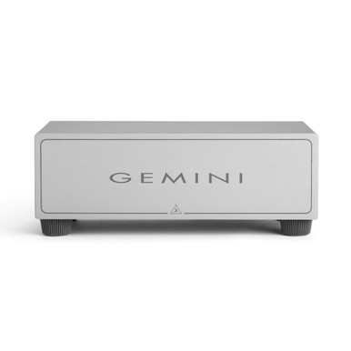

Sure. These are difficult to recommend as I don’t know your budget or the exact components in your systems, but here is one (if you’re in the United States):
They have a 60-day money back guarantee. If you feel like it makes a big difference, then it’s a solid platform for future power upgrades. The incoming C19 power cable (wall → conditioner) makes a huge difference, as do the C15 cables from this box to each of your components. Depending on your budget, I’d definitely suggest putting some aftermarket power cords to your amp and dac.
