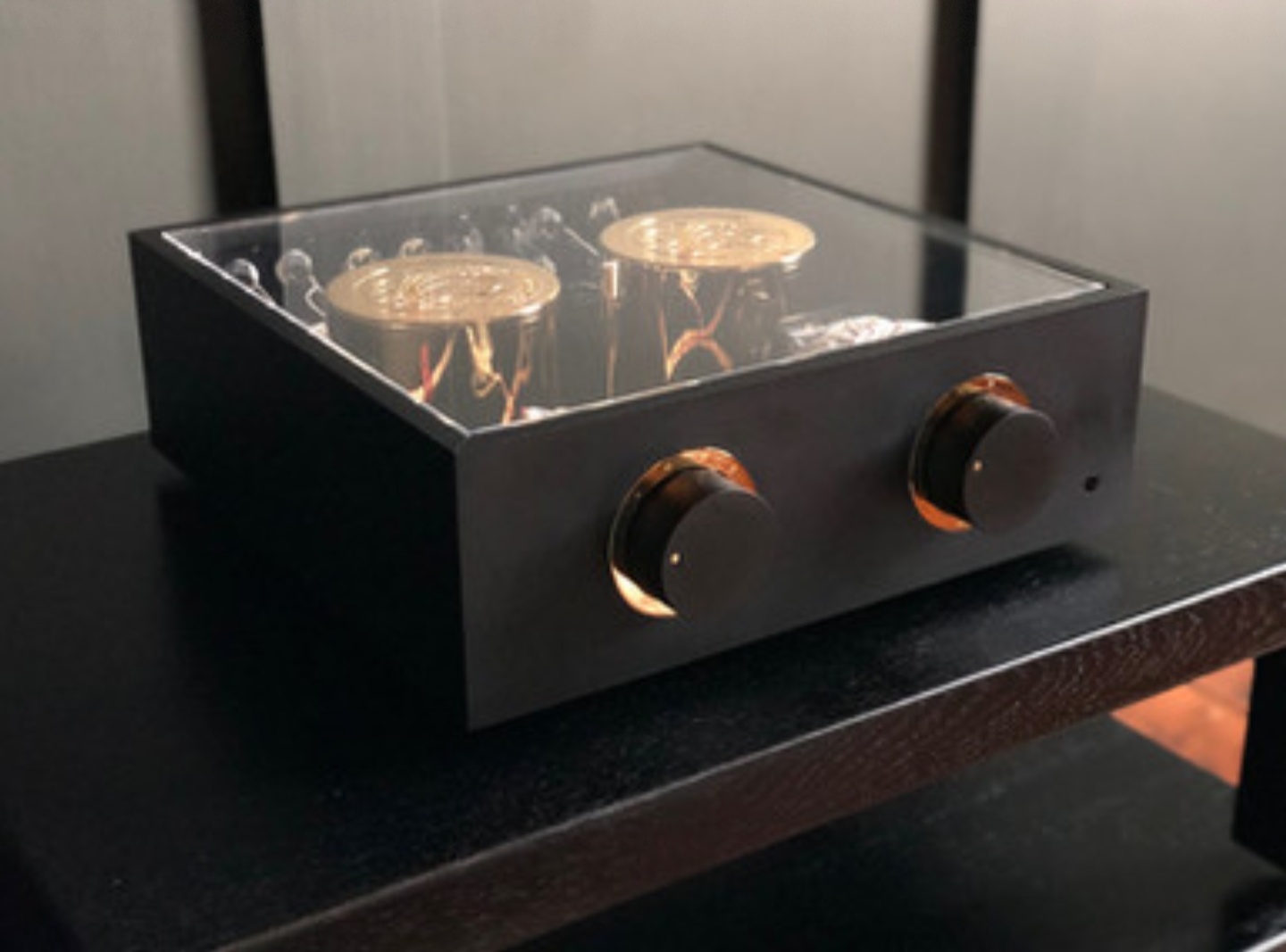

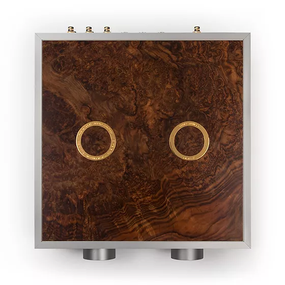

No surprise that a company named bespoke would be english.
Look at this though…
I spent like 10 minutes playing with their configuration tool.
You shouldnt of told me about the tool…
This:
The internals are very neat and pretty
Those passive pres look ridiculous. I’m in love, but I’m afraid to go looking for a price lol
